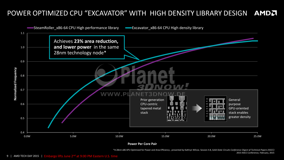

Some clockspeed numbers (from Stilt) in Prime95 Large FFT using the FX-8800P:
http://www.overclock.net/t/1560230/jagatreview-hands-on-amd-fx-8800p-carrizo/350#post_24278342
20W cTDP= 1990 Mhz
42W cTDP= 3050 MHz
Extrapoltaing from the chart below, two modules @ 10W cTDP would have come out to be ~1540 Mhz.
So XV has ~78% of the clockspeed at 5W module compared to 10W module.
Furthermore, XV is greater than 20% faster than Kaveri @ 5W module and slightly less than 10% faster than Kaveri @ 10W module. At 4W module, it looks like the XV clockspeed (probably around 1375 Mhz) increases to ~30% faster than Kaveri.
So the strength of the XV design (as we have read many times before) is at low power consumption. However, If that marketing graph holds up in real life the gains are most pronounced at 5W module and particularly 4W module.
So at 4W per module, I wonder how these XV micro cores compare to cat cores at the same power consumption?

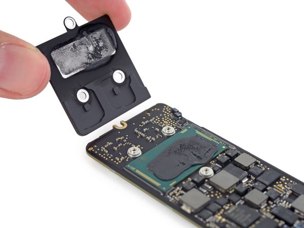

As an example of different cooling gear for different TDPs I thought these teardowns of the 13.3" and 15" Apple Mac Pro Retina (late 2013) models were interesting:
https://www.ifixit.com/Teardown/MacBook+Pro+13-Inch+Retina+Display+Late+2013+Teardown/18695
pFQhlHe4snFvJwZF.huge
https://www.ifixit.com/Teardown/MacBook+Pro+15-Inch+Retina+Display+Late+2013+Teardown/18696
tFHaDvvCPpY626UL.huge
The first laptop is the 13.3" model with a 28W Haswell dual core.
The second laptop is the 15" model with a 47W Haswell quad core with Iris Pro graphics.
Copper heatsink size is about the same for both, but the 47W model uses two fans (each with blowing air into a very small aluminum finned area). This compared to the 28W model which only uses one fan, but notice the aluminum finned area is much larger.
So overall, I would say both 28W and 47W set-ups have the following amount of material:
Copper heatsink material: About the same for both the 47W and 28W
heatpipe: twice as much for the 47W
fans: twice as much for the 47W
aluminum finned material (this is the part next to the fan): About the ~same total weight for both, the 47W has less of it for each fan.
So it appears the amount of metal used for cooling isn't really that different between the two TDPS, but difference in ventilation is much in favor of the 47W.

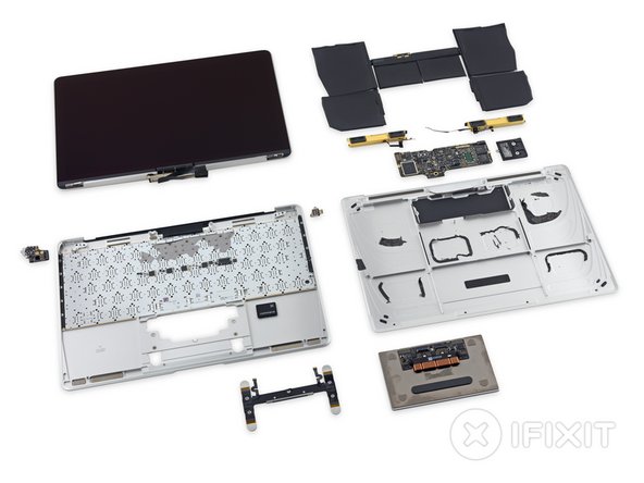

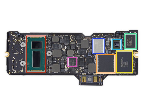

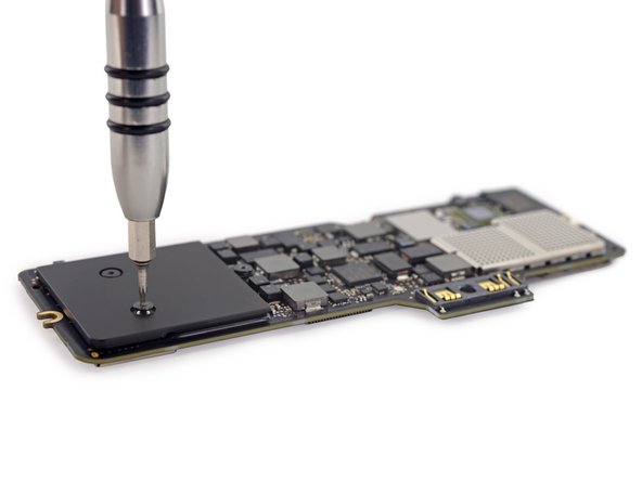

In the contrast to the 28W Haswell 13" Mac Book Pro and 47W 15" Haswell 15" Mac Book Pro (both shown above) we have the 4.5W Broadwell 12" Mac Book Retina (shown below):
https://www.ifixit.com/Teardown/Retina+Macbook+2015+Teardown/39841
O5qYbWSJKkqrV4Ub.medium
Since the chip is so low power it doesn't need a fan and notice the small size of the system board PCB (Core M located on the far left outlined in red, below):
OMwAHRdkS66hiRZR.medium
And the small heatsink for the Core M processor:
MZUNvNxyatgfwPYq.medium
iGMNpqmRcKsmUMKH.medium
