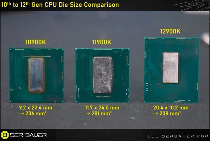

Looking at how big GC is, on 10nm, Intel had no choice but to implement the hybrid system in order to save area first, followed by the added inherent benefits of GRMT, which they could tweak up to a satisfactory ipc level. The other issue to consider is per core power consumption at the frequencies required to compete with the 5950x. This definitely required a hybrid system. The 12400f, with its 4GHz all core clocks is positioned closer to the optimum v/f to not look too shabby in power consumption vs the 5600x. Those clocks won't allow the 12900k to shine vs 5950x, though power consumption would've certainly been noticeable, in a good way.
Looking at how big GC is, on 10nm, Intel had no choice but to implement the hybrid system in order to save area first.
Actual die of 8+8+igpu is smaller than the 11900 and 10900k, they made the whole chip larger for some reason, maybe to have space for future growth.
