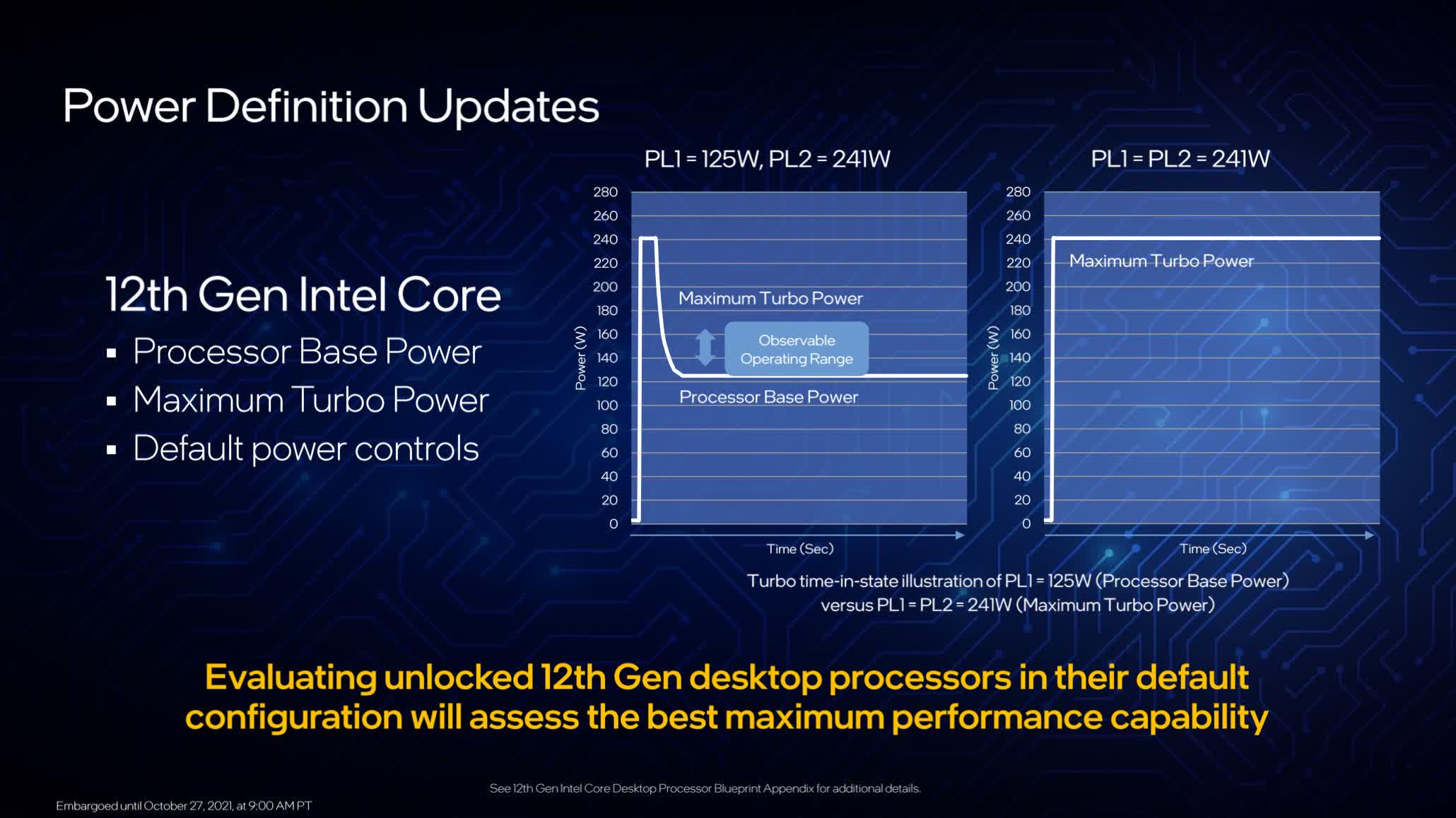

Reality: Power throttling in Blender at default 241W power limit.
IIRC only K CPU have infinite turbo, "vanilla" CPU will go back to base clock after the burst.
You can still set the locked parts to have infinite Tau, just that the recommended stock setting is to not do that.
Non-K parts not having infinite turbo is a myth, the CPU type has no influence on turbo settings: it's all decided by the motherboard, at UEFI level. I've seen both Z and B chipset boards with unlocked power & turbo timer settings for non-K CPUs at stock. Everything comes down to VRM quality and whatever the manufacturer decides.
Here's a very clear example from ASRock, see how VRM quality has a massive influence on max power (and may have further effect on Tau):
BFB stands for Base Frequency Boost.
It's the "intended" behavior from Intel.
The fact the MoBo can ignore that doesn't make it a myth.
The intended behavior from intel is Pl2 for tau seconds and then Pl1, even for the unlocked K parts.
volume 1, page 76
Intel is also making these processors have ‘infinite Turbo time’, meaning that with the right cooling, users should expect these processors to run up to the Turbo power indefinitely during heavy workloads.
So if Intel puts that in their design docs and nobody follows it, I guess we just blame the OEMs? Also, I thought PL1=PL2 now?
Here's Igor on the subject....
That's what I understood...
No, we blame reviewers that take super hardcore overclocking mobos, don't change any setting and then try to sell the performance but also the power draw as normal, stock, default, or whatever else.
Also intel didn't say PL1=PL2, intel said PL1=PL2=241w=maximum turbo power/power limits lifted, you can't just truncate half the equation and claim that that's what they said.
TDP is still PL1=125W,PL2=241W=processor base power/TDP
It's the same two power settings you could have with previous generations.
