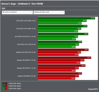

Senua's Saga - Hellblade II GGPU test​
Test scene
would be interesting how is 7800XT
Well, I said it would be a disaster for most cards. It clearly likes AMD cards, which is ok and besides the point really.
The point is, VRAM is irrelevant for one more UE5 game. Also shown here.
Screenshot 2024-05-21 at 13-43-11 Senua's Saga - Hellblade II PC Performance Benchmarks for Gr...png
You will take that 1080p 37fps on the 3060 12GB and you will like it! Which is beaten by many 8GB cards too.
When I tell you that UE5 is not vram limited and that you will need correct settings anyway, people here are mocking. Keep mocking.

Gamegpu above says the 3070ti is at 39fps at 1440p. I mean it's already unplayable. it is a game with heavy camera movement in all directions. So my question is, the user starts the game at 1440p on a 3070ti. He sees that right off the bat, the game is lower than 40fps. What is the correct course of action? SET the effing thing at correct settings, to make it playable.
Did you see any 3-4fps drops above on the 3060ti? No. Is it bad? Is it ugly? Is it unplayable? Far from it.

At 1440p, that the user above saw, the 3070ti, according to gamegpu, is at 39fps. Even if it had 32GBs it would still be unplayable.
The 3070ti at 1440p/DLSS goes to 57fps. Take down a couple of settings as I did above and boom, no problem.
At 1080p, the top 8GB with the last 8GB card, have 84% difference. The 3070ti is on par with the 4070. The 3060 is beaten by EIGHT 8GB cards. Gamegpu has shared their testing save file, so people can test themselves.
The top 12GB card with the last 12GB card have 86% difference. Yes, it is absolutely gpu power limited. And unplayable on most cards as it is. Correct settings are mandatory for 95% of the users out there.

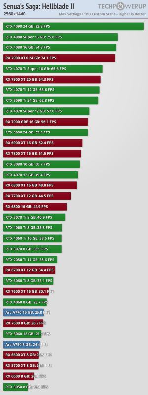

Techpowerup also published their own findings.
4060ti 8Gb vs 16GB same performance.... 7600XT vs 7600 have like 2-3fps differences (1080p-1440p).
So where are we getting at, is what I've been telling you all along. 7600XT and 4060ti 16GB users, essentially bought 1080p cards, where they are still going to use correct settings and they will have half their framebuffer sitting there, for truly heavy games.
Really can't wait for the genius that will say, HEY the 4060ti 16GB is like 62% faster at 4k with its whole 18fps,lol.
PS Also techpowerup is showing a much better picture for Nvidia cards. Just so you don't think gamegpu has anything against AMD that is....
nVidia has proven to be better at memory management than AMD, but it's not significant. It could mean the difference between an 8GB AMD card dropping FPS sooner than an nVidia one, but I don't have any apples to apples comparisons especially for later tech.
We can conclude that this benchmark has no real Vram impact on any gen of GPU.
It's hitting Radeon cards differently than nVidia with the latest architectures, but we can see the 7600 and 3060 12GB matching nearly,. showing the nVidia code path superiority but no Vram issue on either or the 7600 would be much lower in FPS.
The Radeon 7900 XTX and XT are perfoming admirably here actually and show great perf / dollar.
