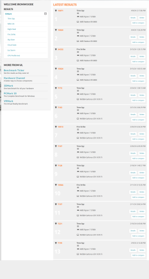

I am still surprised to see my Time Spy scores go from 7000 to 15071 when I upgraded to my RX 6800 from a 1070 Ti.
If you are referring to me sir, I honestly don't know how the 1060 3GB comes into the discussion, because I never mentioned it. However with correct settings, many things get improved indeed. I don't know why PC users in this thread, have the urge to mock this.
This is the discussion about (mostly) 8GBs however, vs everything above it, as it has turned out.
Your Time Spy score, has nothing to do with VRAM though. Instead it has everything to do, with gpu power.

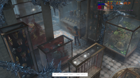

These are two screenshots of Time Spy on my GTX 970. VRAM maxes out below 3GBs, obviously because Futuremark wanted to include the 3GB models of the era too.
Although the test is old, the assets aren't that bad and for less than 3GBs, they managed to produce a decent image. Imagine what they can do, with 2.5 times that! And keep in mind that the vanilla Time Spy is a 1440p affair. I will have to check what the extreme is doing.

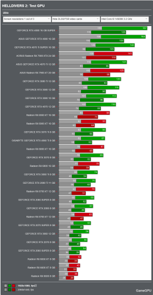

Also did we talk about Helldivers 2 yet? No? I mean why would we? Only half a mil people have played it yet.
edit OMG that almost half mil, is the concurrent players. The owners of the game are WAY above that, but inconclusive.
How does it fair?
Screenshot 2024-04-12 at 14-22-27 HELLDIVERS 2 PC Performance Benchmarks for Graphics Cards an...png
I mean the 4060ti 8GB is almost three times faster compared to the rx6600, but all 8GB cards are the same right? And they should be absolutely priced by their framebuffer... It is even beating the 6800s, hmmm.....And the 3060 12GB is barely playable even at 1080p, in spite its 12GBs. Weirdness galore.... Hmmm....

PSOLORD is so humble, really. He should be a much sought after "correct settings" consultant for game studios! I don't know why he wastes time making videos for fools like us :p
