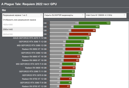

GameGPU is known for having terrible benchmark scenes that don't represent game performance very well. Here is a link to their test sequence for Helldivers 2. Since I don't own the game, I'll let you decide if this one is a good test scene or not.
Probably the worst example I've seen of their terrible test scenes is from Doom (2016). They literally just run around an empty room at the beginning of the game and fire the pistol at nothing a few times. It's a complete joke to use this as a benchmark scene for a fast past bullet storm type game.
If there is an issue with a game with VRAM or other performance issues, you can pretty much guarantee that GameGPU will be the least likely outlet to show the problem. Case in point, their Plague Tale results. Looking at it, you'd say 8 GB cards have no issues.

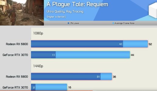

Let's check what another reviewer found:
Completely different story. There are, of course, other problems like bad LOD and reduced texture IQ in some games with 8 GB cards which you would never know about if only looking at GameGPU. In other words, you can't rely on GameGPU to give you a good idea of actual game performance or IQ.

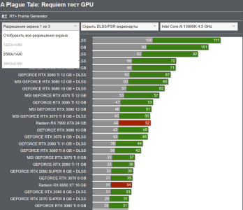

Edit: @SolidQ pointed out that the GameGPU Plague Tale test was done pre-RT patch. I have posted the GameGPU Plague Tale tests with RT in post #2058 but the results are the same, they fail to show the VRAM issue with 8 GB cards.

You compared non RT vs RT bench, be more careful
Are you sure? I don't speak Russian so I have to rely on the translation which, as far as I can tell, says that if the graph says maximum quality, that ray tracing is on if available.
Known for terrible benchmark scenes? No. Having some objections by users (myself included), calling for harder tests, in some games, yes. There is a reason for that however. When you have a delta from the 6600 to the 4090 to test, you must find a location that everyone can run. After all, that's why they have 1440p and 4k (and 8K in some cases) graphs too.

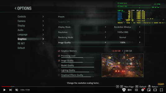

Even worse example, Resident Evil 3, from 4 years ago. Running on a freagin Radeon 7950, with 3GBs. Look at what the estimation was suggesting.
Screenshot 2024-04-15 at 12-57-28 Resident Evil 3 8600k 7950 OC 1920X1080 maxed.png
The game was requesting 4.14X more vram than what the 7950 had. Yet it run adequetaly, especially for a PS3 era card. This is a DX12 game, for which the 7950 is a complete no go. But still...
