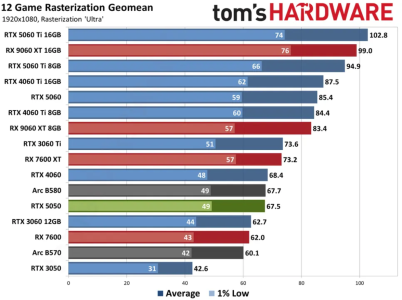

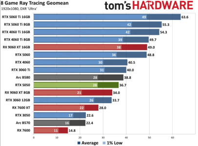

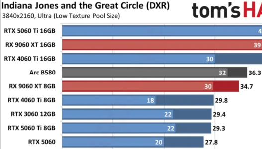

Extra VRAM helping the 5060 Ti more than the 4060 Ti in raytracing.
This is academic once again. None of these cards is healthily playable at these settings. The 5060ti which is the strongest, is borderline above 60fps with drops below 50fps. No one in their right mind would use these cards at these settings, not even at 1080p.
Once you drop them to manageable settings, vram will become irrelevant for the most part. And that's what I've been saying....for.....ever.
But look at how much 9060 XT 8GB suffers compared to the 16GB in plain raster!
How much does it suffer? And why isn't the 5060ti suffering that much? And why is the 3060ti still quite faster than the 3060? And why the 5060 destroys both of them and the B Arcs? Hmm?

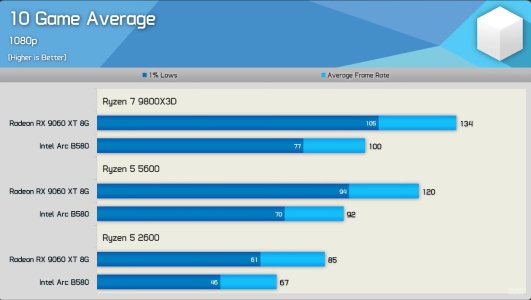

If video ram was THAT important, the 9060XT wouldn't be 34% faster than the B580, while the latter enjoys 50% more vram. People in this thread can argue all they want. Things are going bad regarding gpu power, not video ram and I have been saying that since I started posting here, with my "wtf are these guys talking about" attitude!

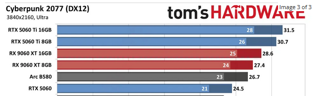

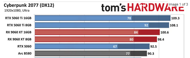

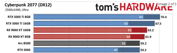

At that price, shouldn't that be expected already?
Care to explain the following?
And if you want to know my true feelings (and of many others here), I would very much like to print these charts on a pillow and smack you hard on the head and across your face so maybe you finally get some sense knocked into you?
psolord
Sep 16, 2009
2,142
1,265
You are buying into a whole different ecosystem with Nvidia. Not the same thing. Also this a technical thread. Prices are a different matter. Not entirely unattached but different.
What are we seeing here? Arc likes Cyberpunk very much. This has been known for a long time.
Other than that, still slower than the 9060XT 8GB and the 5060ti 8GB.
That's not very nice. Give me irrefutable facts, with usable benchmarks, within the playable realm and show me how 8GB cards are bad, and the sense will be automatically be smacked into me. While you are at it, also show me what kind of image quality the 8GB framebuffer can really fit with correct settings.
