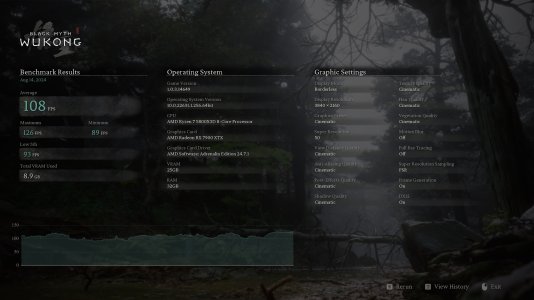

AMD should have a driver out soon.
Steve says he will test VRAM usage in game so stay tuned for that.
Lumen is on when RT is off, which explains why the lighting looks so good to me using very high.

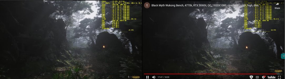

Hitchy, blurry, pixellated mess of a slideshow.
Doesn't help your cause. Sorry.
A more experienced development team could have made this benchmark run better.
Use the higher bitrate options. Image quality is fine and the stream was uploaded raw. If anything, you can clearly see the difference between various options and of course, how vram is irrelevant, while the performance still tanks.
Other than that, you are being dismissive and are deflecting as usual.

It's a 4770k, with a slight overclock to 4.5GHz and 1866 ram, it struggled to handle my playstyle in AC: Odyssey; a 6yr old game.
The 4770k of the above example, has nothing to do with the bad performance of the video card. If anything, it would inhibit the performance, when the framerate was starting to get better, due to the correct settings.
Please see the comparison shot again.
The left one, which also looks worse, is the one with the native res at cinematic settings. The right one, with the correct settings, lools even better while being 2.32X faster. This is why I insist, to not crank everything over 9000.

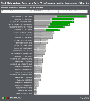

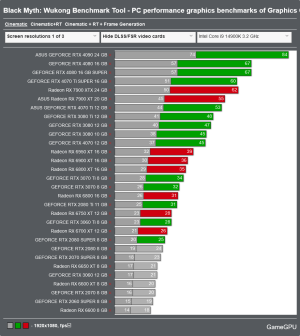

Still, how can one commit? 1080p for which games and at what settings? Do you want correct settings or FAFO settings? Did you see Wukong results above? They updated with a 4090 too.
Screenshot 2024-08-21 at 10-58-27 Black Myth Wukong Benchmark Tool - PC performance graphics b...png
Congratulations. The 4090 is now a 1080p card and still has framedrops.
You will all have to make up your mind. What do you want? Do you want a reasonable gaming experience with correct settings or you want maxed out everything? Because the difference between the two is like 1000$.

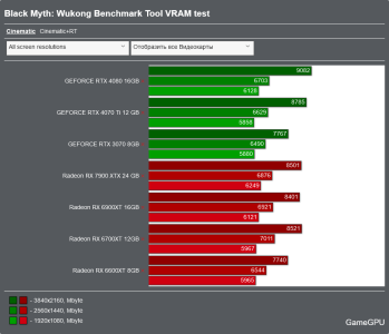

Can you settle without using RT? Good! Here are the non RT results, with VRAM analysis.
Screenshot 2024-08-21 at 11-08-08 Black Myth Wukong Benchmark Tool - PC performance graphics b...png
Screenshot 2024-08-21 at 11-07-59 Black Myth Wukong Benchmark Tool - PC performance graphics b...png
You don't need a 30 minute run to make heads or tails out of this. You need 4070ti super and ABOVE, for 1080p no RT. VRAM is at 6GBs.
A 5060ti, even with 8GBs, will not be able to run this, without correct settings anyway.

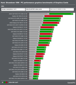

Here is a new one. This one is Cry Engine 5.11.
Screenshot 2024-08-21 at 11-13-00 Hunt Showdown 1896 - PC performance graphics benchmarks of G...png
I mean, this thread was all about how more vram will provide a better future proofing amirite? I don't see much future proofing at the 28fps of the 3060....
The 3060ti is still 36% faster.
Vram is at 6-7GBs.
