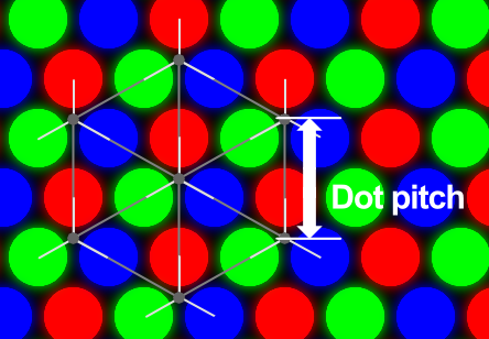

Yes they do. There are three distinct phosphors, one for each color, arranged in a specific pattern, and that pattern determines the pixel count and orientation. You can't just invent phosphors in other locations for different resolutions, they're coated on the inside of the CRT glass.
I'm not entirely sure on the specifics on how it is done, but CRT's do not have a fixed grid of pixels. Looking on the specifics on how it is done, there is still no fixed pixels. Anyone who ever used CRT's as their monitor, will know this.
Here is a page that describes the difference between the monitors tech's, and it too says the same thing. CRT's do not have a fixed resolution.
http://en.wikipedia.org/wiki/Comparison_of_CRT,_LCD,_Plasma,_and_OLED
No native resolution. Currently, the only display technology capable of multi-syncing (displaying different resolutions and refresh rates without the need for scaling). Display lag is extremely low due to its nature, which does not have the ability to store image data before output, unlike LCDs, plasma displays and OLED displays.

It's not quite "pixel" but it is a fixed, immutable pattern.
Yeah, there is some sort of substructure of phosphors, but the resolution is not fixed. I am assuming they get away with it because they are aligned in a much smaller grid than the size of the pixels they light up with the electron gun.
Crt's don't have pixels but lines instead. There's no way to shoot invidual pixels with electron gun so color pixels have to arrange in lines to be able to refresh each subcolor with their own refresh cycle.
Theres' few kind of different masks to lines which makes those lines appear more pixel like but after all crt's newer could have real fixed pixels.
