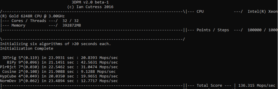

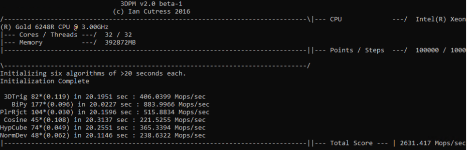

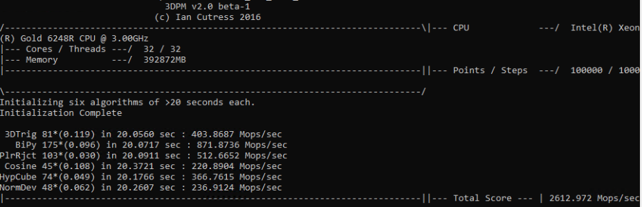

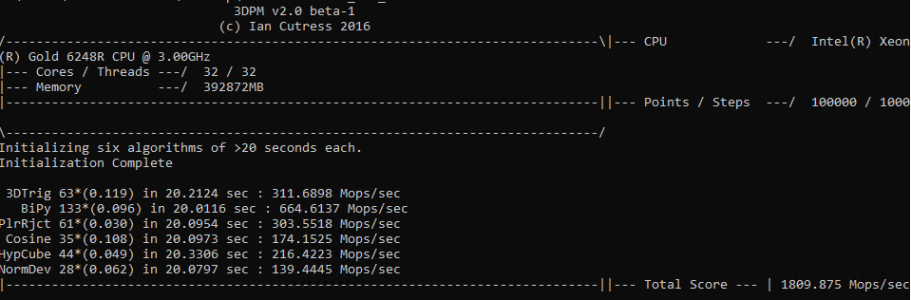

It compiled but not without some "head scratching" thanks to being a Visual Studio project.
Gonna try to test it on my Tiger Lake laptop when I get the time to see if the AVX512 optimization helps or not. There are no explicit AVX512 instructions in the code unfortunately.
DrMrLordX
Apr 27, 2000
23,227
13,310
From what I understand, Dr. Cutress got a third party to help him with the final builds of 3DPMv2 that he used in some of his later benchmark articles for AT. It did utilize AVX2 and AVX512, and apparently it didn't rely just on autovectorization via OpenMP.
28,174

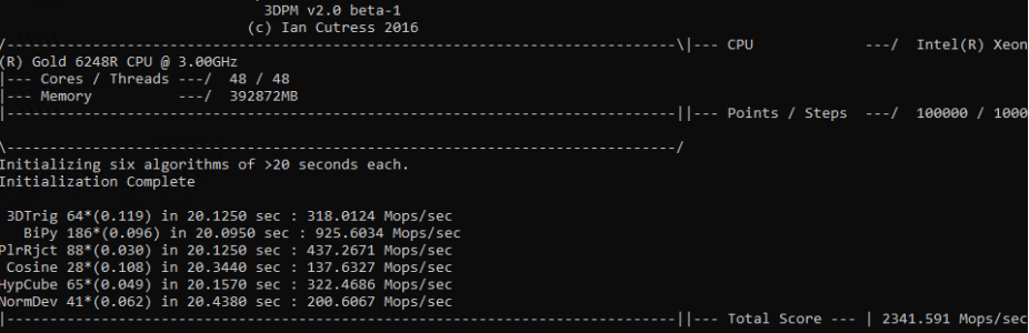

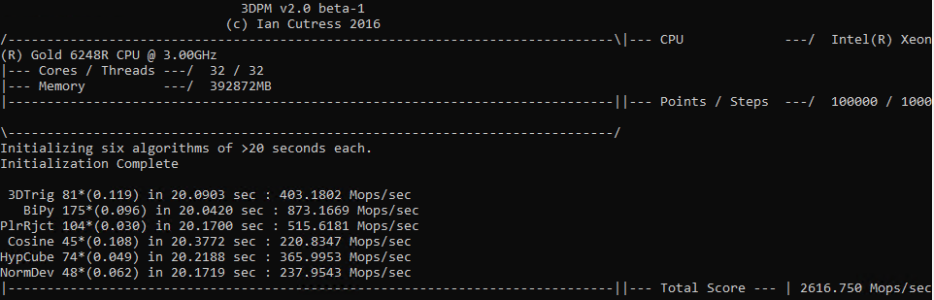

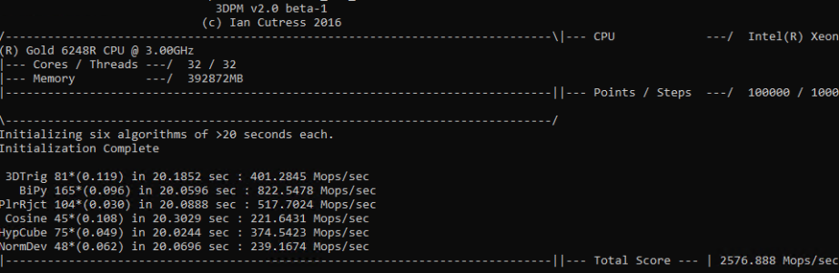

19,218

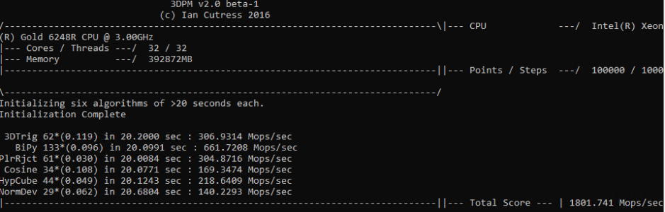

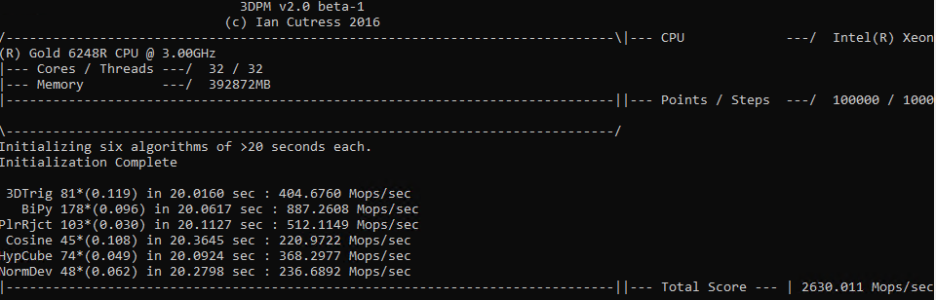

Pretty awful. Looked in the IDE project options and enabled OpenMP.
No ISA extensions
SSE
SSE2
AVX
AVX2
AVX-512 256-bit vector length
AVX-512 512-bit vector length
Highest score came from the AVX executable.
Now I need to figure out how to compile this as a 64-bit executable. I hate Visual Studio.

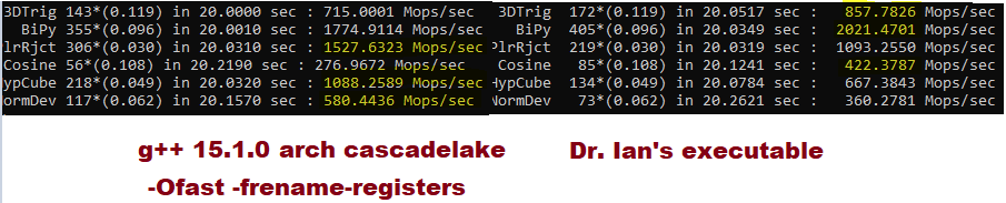

Looks like Dr. Ian got a pretty seriously heavy uplift from the manual optimization.

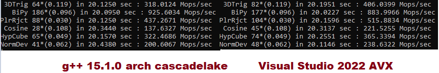

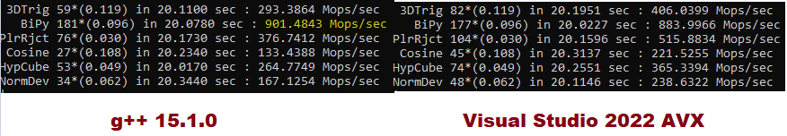

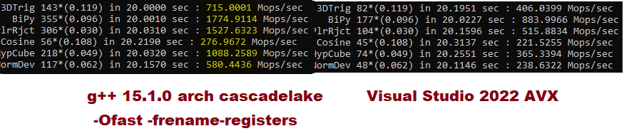

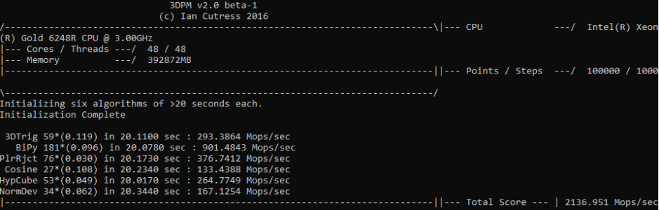

I think I'm in love with a new compiler: https://github.com/skeeto/w64devkit/releases/tag/v2.3.0
Command-line: g++ -Wall -g -fopenmp -static Dr_Ian_3DPM.cpp
It's fully PORTABLE!
Just look at the side by side comparison with VStudio's highest score:
g++ -Wall -g -fopenmp -static -march=cascadelake Dr_Ian_3DPM.cpp
AND THEN...
g++ -Wall -g -fopenmp -static -march=cascadelake -Ofast -frename-registers Dr_Ian_3DPM.cpp
BEAST MODE ACTIVATED!!!!! :eek:
Despite losing three test scores to Dr. Ian's hand optimized executable, the open source compiled exe comes out a winner by 9.97% !!!
Thanks, @DrMrLordX ! A simple mention of 3DPM led to so much amazing learning!
28,174
19,218

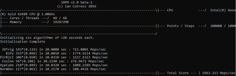

So two advantages of that BEAUTIFUL portable compiler.
The EXE compiled as 64-bit and it uses some better threading model (or maybe better version of OpenMP) because VStudio EXE was doing max 80% CPU utilization but the g++ 15.1.0 EXE maxes the CPU cores out so much that even mouse movement becomes laggy so it makes for a really great MT stress test too.
Since you have enabled -Ofast it would be nice to test if the results are still correct. It does not matter how fast something is, if it is producing wrong results;) If you want to be on the safer side, stick to -O3. For further reading https://gcc.gnu.org/onlinedocs/gcc/Optimize-Options.html#index-Ofast
It would be also nice to list flags you passed down to MSVC, for completeness.
AVX512F target but that CPU IS Cascade Lake.
Not really, not to mention with gcc you can enable only avx512f without specifying the arch.
Code:
/vlen=512 /Yu"stdafx.h" /ifcOutput "Release\" /GS /Qpar /GL /analyze- /W3 /Gy /Zc:wchar_t /Zi /Gm- /O2 /Ob2 /Fd"Release\vc143.pdb" /Zc:inline /fp:precise /D "WIN32" /D "NDEBUG" /D "_CONSOLE" /D "_UNICODE" /D "UNICODE" /errorReport:prompt /WX- /Zc:forScope /arch:AVX512 /Gd /Oy- /Oi /MD /openmp /FC /Fa"Release\" /EHsc /nologo /Fo"Release\" /Ot /Fp"Release\Dr_Ian_3DPM.pch" /diagnostics:column
