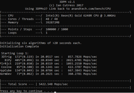

Progress:
- Added Normal Distribution PRNG
- Added NormDev function
- Converted to function pointer array to add new algorithms quicker
Here's a mid-beta test to try:
https://dl.dropboxusercontent.com/u/49768099/3DPM.rar
I've included the original 3DPM and the new v2, as well as a screenshot.
v2 only has three algorithms at the minute, still unoptimized - each alg runs for 15 seconds in a do(){while}; loop which works on OpenMP time still.
So far, on a 3.5 GHz i7-3960X:
3D Trig seems 25% slower (149.4 from 205.9)
BiPy is 50% faster (369.9 from 235.7)
NormDev is 50% faster (67.6 from 43.8)
Still to do:
- Add Polar Reject Algorithm
- Add Cosine Algorithm
- Add Hypercube algorithm
- Find why 3D Trig is slower
- Optimise for particle/step
- Make display nicer
- Output result text file
- Create benchmark upload site / security
- Some other stuff I can't think of at 4am
Edit: Just tried on a E3-1225 v5
v1 vs v2
3DTrig: 99.62 vs 114.97
BiPy: 110.37 vs 194.02
NormDev: 21.19 vs 43.48
So big speed ups on each.
Edit2: A6-7400K
3DTrig: 24.79 vs 25.72
BiPy: 29.20 vs 55.46
NormDev: 5.67 vs 11.65
Edit3: i3-6100TE at 35% OC
3DTrig: 94.86 vs 80.08
Bipy: 106.41 vs 167.17
NormDev: 21.28 vs 32.73

Thanks for the download. For those who don't know, you'll need MSVC 2015 redistributable to run this thing unless you have the compiler installed on your system. Anyway, here are numbers from my 7700k (currently @ 4.5 GHz, 2100 mhz NB, DDR3-2400 CL10):
v1 vs v2 vs 3DPMRedux
3DTrig: 58.1377 vs 61.5679 vs 141.28035
Bipy: 68.0851 vs 130.0988 vs NA
NormDev: 13.3856 vs 27.2759 vs NA
Big improvements on Bipy and NormDev. 3DPM is still faster in 3DTrig mode, but not by much vs v2 Bipy. Would definitely like to see some code snippets on v2 if possible.

Progress, 3DPM v2.0 b1
- Added all algorithms
- Adjusted layout with function pointer array
- Tidied up the look, detects CPU
- Auto sets process to high priority
- adjusted particles/steps to 100k and 1k
- Does some initialization
To do:
- Should add a 10 second gap between tests, to allow cool down for turbo.
- add more comments
- Find a FP PRNG
- Identify bottlenecks
Updated download in same place:
Results breakdown on an i7-3960X at 3.5G:
v2b1 against v1.03
Code:
Stage 1: 3DTrig      - 170.75 : 165.50 (+  3.17%)
Stage 2: BiPy        - 433.75 : 186.90 (+132%)
Stage 3: PolarReject - 208.88 : 123.46 (+ 69.2%)
Stage 4: Cosine      -  84.41 :  92.80 (-  9.04%)
Stage 5: Hypercube   - 143.17 :  59.93 (+139%)
Stage 6: NormDev     -  76.54 :  38.98 (+ 96.4%)
Total Score: 1117.49 vs 667.56 (+67.4%)
This was on my main work PC, which has tons of crap in the background. No 3DTrig and Cosine seem very susceptible to it.
