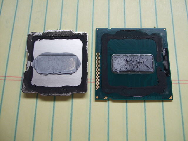

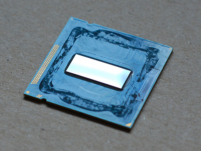

Removing the IHS from an i7-3770K
Maintain a level blade and gently insert it between the green part of the chip (PCB), and the silver part (IHS). I found it best to start on a corner. From what I've read, care needs to be taken not to scrap the PCB, as key parts of the chip reside very close to the surface. Slowly and gently, rock the blade between the two until it penetrates. Then slide it around the perimeter. See the pics to visualize the die so you don't push the blade in too far. The IHS will come off easily once you have completed severing the glue which is removed with gentle scraping with credit card or finger nails; isopropyl alcohol doesn't help much. When finished cleaning up both pieces, apply TIM to the die, place it back in the MB, and gently place the IHS on it. Lock it into place in the MB with the mounting bracket that will hold the IHS to the chip securely thus keeping you from having to glue down the IHS.
I'm a pretty big fan of Arctic Silver 5 (AS5) and used it both on the die, and on the outside of the IHS. My "factory" configuration had a good 120 h of load/idle cycles on it. As you probably know, AS5 has a breakin period associated with it...200 h according to Arctic Silver Incorporated. One can argue that this claim is valid based on the delta temp data.

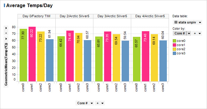

I ran the stress test described above for ~2 h period and used the geometric mean of the temps per core as the "average" temperature over that time period. I repeated this for a total of 4 nights, but lost the data on day 1 due to an overwrite on my part! Here are the average corresponding temps per day; there is a nice decrease out to day 3 where it more or less plateaus off. Perhaps that is the AS5 "breaking-in." Also note the error bars correspond to the measured ambient temp which ranged between 75-77 F or 1.1 C. You can see that some values at day 3 and 4 are not different when accounting for this:
As well, here is a plot of the delta temp, that is, the values subtracted from the stock results indicating the magnitude of temperature decrease:
And to be sure this horse has been beaten well after it died, here are the results compiled in a table:
Conclusion
For this example, a decrease in load temps was observed after delidding an Intel 3770K and replacing the factory TIM with AS5. The magnitude of the temperature reduction was not even across all cores, and ranged for -2C to -12C. The data are consistent with Arctic Silver Inc.'s claim that the TIM requires a break in period. This has to be one of the cheapest modifications to gain lower operating temperatures which can be converted into higher voltage and likely higher clock rates. The unevenness of the decrease is puzzling. Since the overall rank order of temps was retained after the TIM replacement, perhaps it has to do with some physical unevenness in the IHS, in the base of the HS, or on the CPU die itself. Investigating this is beyond the scope of this exercise.

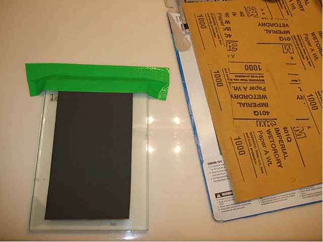

The process of lapping in detail will not be reviewed here, but in summary, one uses wet/dry sandpaper and a flat surface (glass usually) to slowly and iteratively grind an uneven surface. The goal of lapping is not be to make a mirror surface, rather, it is to make flat surface.
Lapping setup:

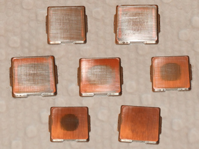

Heatsink lapping (220 grit --> 320 grit --> 400 grit --> 800 grit --> 1000 grit). Read this composite pic from left-to-right and from top-to-bottom:
As evident in the photos, the base of the NH-D14 is actually quite flat from the factory.
IHS lapping ( 400 grit --> 800 grit --> 1000 grit). Read this composite pic from left-to-right and from top-to-bottom:
As evident in the photos, the IHS on this 3770K was quite concave, that is, higher in the middle than elsewhere. "Flatness" was achieved in this case when no more silver color remained on the IHS.
