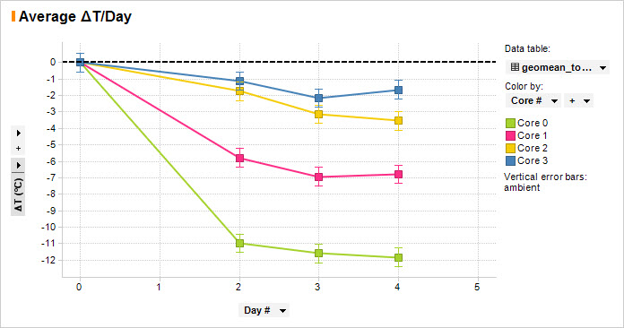

I ran the stress test described above for ~2 h period and used the geometric mean of the temps per core as the "average" temperature over that time period. I repeated this for a total of 4 nights, but lost the data on day 1 due to an overwrite on my part! Here are the average corresponding temps per day; there is a nice decrease out to day 3 where it more or less plateaus off. Perhaps that is the AS5 "breaking-in." Also note the error bars correspond to the measured ambient temp which ranged between 75-77 F or 1.1 C. You can see that some values at day 3 and 4 are not different when accounting for this:
As well, here is a plot of the delta temp, that is, the values subtracted from the stock results indicating the magnitude of temperature decrease:

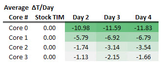

And to be sure this horse has been beaten well after it died, here are the results compiled in a table:

For this example, a decrease in load temps was observed after delidding an Intel 3770K and replacing the factory TIM with AS5. The magnitude of the temperature reduction was not even across all cores, and ranged for -2C to -12C. The data are consistent with Arctic Silver Inc.'s claim that the TIM requires a break in period. This has to be one of the cheapest modifications to gain lower operating temperatures which can be converted into higher voltage and likely higher clock rates. The unevenness of the decrease is puzzling. Since the overall rank order of temps was retained after the TIM replacement, perhaps it has to do with some physical unevenness in the IHS, in the base of the HS, or on the CPU die itself. Investigating this is beyond the scope of this exercise.

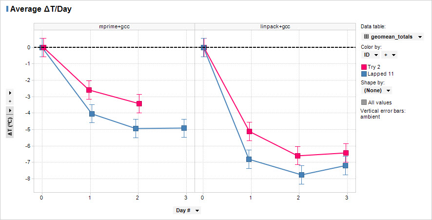

Rather than showing a per-core analysis which would make for a rather busy graph (4 cores x 2 conditions), a more simplistic "Lapped" and "Non-lapped" average results across all 4 cores is shown for each of the stress methods:
The delta temp spread for the averaged results ranged from 0 to -9 for the mprime+gcc experiments and from -1 to -12 for the linpack+gcc experiments.
Each line is relate to the factory TIM/unlapped result represented by the y=0 dashed black line. Again, these are delta temps which are relative to that factory result. The pink line shows the average drop in temp across all 4 cores for the unlapped results while the blue line shows the average drop in temps across all 4 cores for the lapped IHS and for the lapped HS. The data show a real but trivial difference after lapping both parts for most days. The exception being in the linpack+gcc stress on day 3. Here the average deltas are within error of each other based solely on the fluctuation in ambient temp.

Based on these data, lapping an i7-3370K and the heatsink used to cool it produces minimal benefits in heat dissipation gains.
