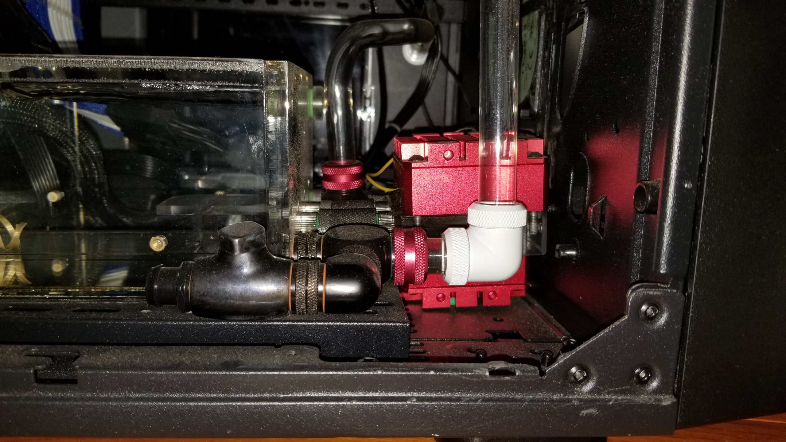

OK, Update! its done. It will do 3950 mhz@less than 65c, but it draws 840 watts from the wall ! I think I will take it down to 3800@1.2 vcore, the 3950 was at 1.3 vcore. The 840 is with the 1080TI @100% folding.. Not sure I remember@stock, but my other 2990wx does 550 watt with a 2060@100%, so probably 600 watts@stock.
Here is a pic
Markfw
May 16, 2002
27,374
16,217
Not sure about the 840 watt now. In linux, with both@100% it was 780 watts@3950 1.3 vcore. I now took it down to 3800 1.2 vcore, and its running 690 watts. (from the wall)
This is where I think I will stay, a nice happy medium. But good to know I can do 4 ghz or more if I want to !
