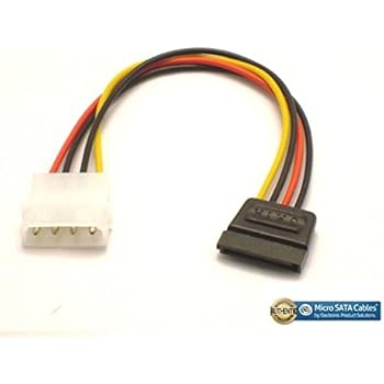

OK, I played around moving the water block around, twice now, and each time the air noise got a lot worse. reservoir is only down less then a quarter of an inch. Letting it run more. I don't think I have any leaks. May run overnight.
Oh, and BTW, the pump uses sata, so I had to get an adapter for that molex on the PSU ( the $15 one I am using to purge)
aigomorla
Sep 28, 2005
21,067
3,573
make sure ur not using sata adapters which are molded... like these:
Those are prone to catching fire... ive lost way too many from fire to count that i avoid those now like a plauge.
I think its because when they are molded like that, there is a higher chance of the 12V_+/- to cross, and it just catches fire....
Make sure the sata head is like this:
You see how each wire has its own slot so wire cross is not possible...
