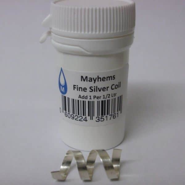

If your running a all copper (no nickle) loop, i highly recommend you drop in a pure 99.9999 silver coil, (NOT STERLING) and use distilled water as coolant.

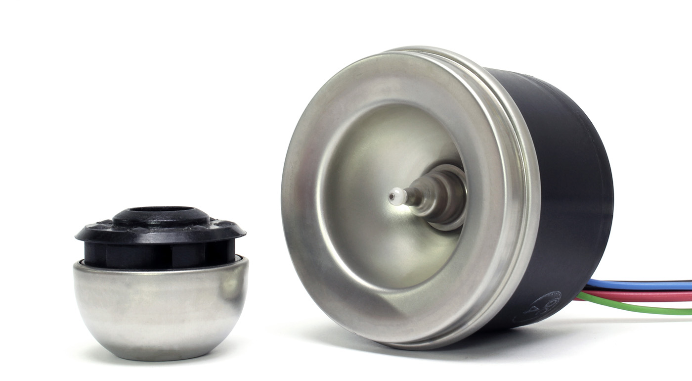

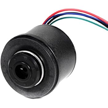

Liang D5 is known for reliability and Quiet.
Liang DDC is known for performance.
If you dont want something that sounds like a mosquito buzzing around, get a D5.
XSPC and eK will use real Liang D5's.
Becareful of the Chinese Knockoff D5's running around.
A REAL D5 has a stainless impeller housing and is not Plastic
vs a Fake Lorwa which tends to cost 2/3rds a real... Barrow uses Fake D5's:
The real D5's are quieter, and more reliable... in my collection of 10+ yrs D5, i have not lost one yet... that is how reliable they are.

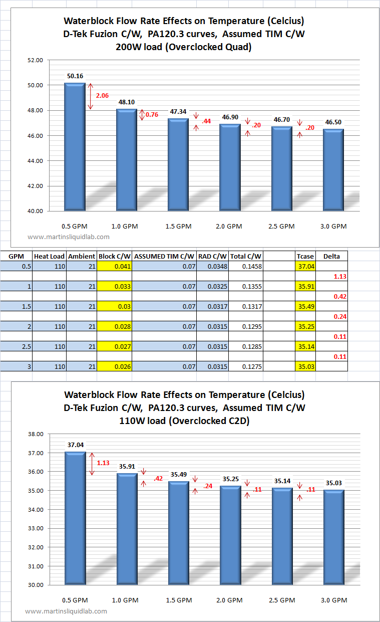

I am thinking 2 360 rads in serial ? Can you tell me which water block is the best performer ? or quality ? And which 360 rads to go with ? and can I use a reservoir and pump combo ? which one ? and if I wanted colors, is there one better than the others ? I read that some have additives that help with maintenance.
best performer depends on what your loop is made of.
One may have less flow restrictions which can boost overall effeciency.
One may have better tubulance which can boost overall performance on cpu block.
The first would perform better on a loop with multi blocks, like a GPU.
The second would perform better on a single cpu loop with high head pressure.
360 x 2 serial for just a CPU loop is overkill.
You will majorly hit the point of dimished returns on your system, which unless you intend to run it door knob silent, is a waste, as your fan on your psu and rear exhaust will make more noise anyhow, as well as gpu.
Dimished returns is a fn of Log, which means the higher you get up, the more flat line it becomes, because father physics gave us thermodynamics which can not be broken no matter how hard we try.

It uses an Original D5 Vario and not PWM... i honestly prefer the VARIO > PWM, as those are all the ones i have had running solid for 10yrs. Also the PWM D5's are harder to prime from what i hear because they ramp at a lower RPM.

Straight distilled is always the best coolant... If you do not have nickle or you do not care about your nickle flaking i recommend you use a kill coil.
https://www.amazon.com/Silver-Coils...d=1532676429&sr=1-2&keywords=silver+kill+coil
Fun fact... i am one of the co founders of the silver kill coil when i projected a pal named Iandh in making them as a reusable, anti microbe over at XS forums... but they are again getting phased out because of the shotty nickle plating job manufactors have done over the years...
I also go by the name Naekuh
http://www.xtremesystems.org/forums/showthread.php?205651-Iandh-Silver-Coils
^ thats when i showed them off for the first time ever.
Ummm Remember loop order only matters when you have a large heat source... excess of 350-400W.
That means in a loop, flow is uniform, pressure is not. Flow is what determines your carrying potential... pressure only matters when you have restrictions. However too much flow... you will hit that wall of diminished returns.
The parts i listed are not what i would consider highly restrictive, so you do not need to worry about pressure, but more flow.
So in short.. in you loop, it will not matter if you pump -> cpu -> rad vs Pump -> rad -> cpu...
There is no such thing as if it stays in the rad longer the coolant gets cooler... <--- this is a complete myth i seriously laugh when i read people preaching this...
Think of heat as cargo... water is pick up trucks... you want more trucks to pick up cargo at a faster rate (flow).
My statement in regards to flow determining your carry potential...

120x1 radiator ~ 150W @ 1gpm flow @ 1300rpm ~ 3C-5C delta coolant temp - ambient air temp.
480 radiator = 4 x 120 = 600W at conditions listed above.

considering that a AIO pump can bearly maintain a flow of less then .25gpm....
And how flow determines the carrying potential of a LCS.
So yes, a custom LCS is substantially better then an AIO. Because i dont think an AIO can pull numbers i listed below.
So u see... from my statement above why we all suggest you aim for somewhere between 1-1.5gpm... because anything after 1.5 is considered extreme diminished returns.
