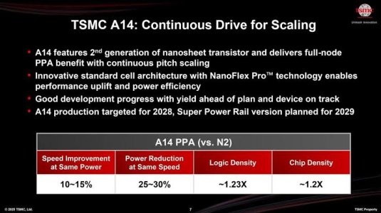

The logic xtor gain from N2 to A14 is mere 1.23X. AMX is fine for server though

Since A16 is only going to get ~ 10% density improvement and will be the first BSPDN for TSMC, I could see AMD holding off for A14 for Zen 7 server parts.
Considering the difficulties OEM's have faced in the past with BSPDN (hot spots limiting overall clock speed), I wouldn't be surprised to see AMD stick with N2 for high end desktop/workstation for some time.
