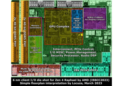

2) If Zen6 leaks are any indication, even desktop is moving towards non-crap tier integrated graphics.
Which it must be noted doesn't make any sense.
IMHO the only real use for DT iGPU is purely for system testing to isolate dGPU related issues from the equation.
In this case only a bare minimum 1 WGP + the GPU basics (video output, HW video ASICs, HDMI multichannel audio etc) are necessary.
99+% of DT AMx system buyers use a dGPU for everything a GPU is needed for.
Sure the esports contingent would make use of such a beefier iGPU for "lossless scaling", or whatever their "must haz uber FPS" addled brains think might boost their gaming fu just a little bit more - but they are hardly a majority revenue driver of desktop sales.
That extra silicon would be better spent on more cache, IO - or just plain saving area, as it's not like silicon area is even remotely 'free' on any process node below 28nm.

Unless that same IOD is also used for their H/HX class laptops. Look at the Arrow Lake H series laptops. Those come with a notably beefy iGPU that's currently besting the 880/890m in many tests. There's something to be said for saving the development costs from another IOD with limited scope.
I for one would be happy to see them bump it up to 4 or 8 compute units. The 2 compute units they currently have are a tiny portion of the chip. Quadrupling the performance of the iGPU would cost only a few dollars.
