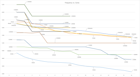

Again, this was in reference to 285K and 9950X comparison where ST clocks are the same. They diverge as cores are loaded.Both are quite important. For client, it is ST boost clock that disproportionately affects the performance.

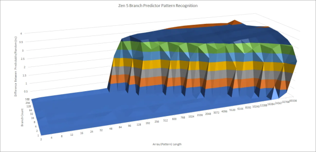

All of Zen 5's front end latency weirdness seems to be caused by the BPU.BPU no (already class-leading by a country mile),

no.All of Zen 5's front end latency weirdness seems to be caused by the BPU.

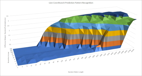

yeah man pipeline flushes hurt when your L1's are tiny.Haven't seen this talked about, but Zen 5's branch mispredict penalty appears to be way higher than LNC's
you should read the chart again.And if it's true, is Zen 5 pipelined way more than LNC? Would it make sense for Intel's next gen core to clock a bit lower than AMD's one then if it just has fewer stages?
Depends a lot on 1. workload (algorithm and dataset) and 2. power limit.by the time all cores are loaded there is a 500MHz gap.

How does this relate?yeah man pipeline flushes hurt when your L1's are tiny.
Similar clocked products, much higher latency in ns for AMD's core?you should read the chart again.

read the chart again.certainly seems that way
Pipeline flushes mean L2 fetches with tiny L1's.How does this relate?
Yes?Similar clocked products, much higher latency in ns for AMD's core?

Absolutely, 100% true. Those TechPowerUp tests only show under default BIOS setting how high the chip will go assuming you have adequate power and cooling.Depends a lot on 1. workload (algorithm and dataset) and 2. power limit.
Furthermore, bare clock speed is not a reliable performance metric especially when more cores get utilized. Cores can clock very high if most of their cycles are spent waiting for main memory accesses instead of actually computing something.
