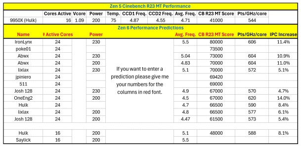

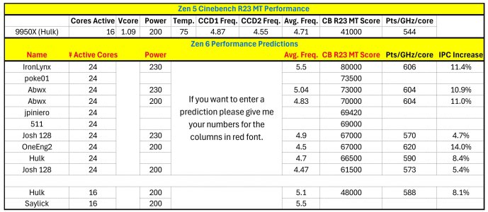

If you are already in the chart please provide the rest of your prediction data. Moving forward I'm only going to enter data if all data in red font is submitted so the chart is complete.
Hi Hulk.
Put me down for 24c, 200W, 4.5Ghz, 67000.
I think that AMD will not go beyond the 200W (or they would have done it with Z5). I think they will get better performance in CB running more cores at a lower clock and that the new IOD will provide uplift beyond the core on this benchmark.

I’m not so fond of these high 200/230W numbers. I guess it’s to squeeze out the last bit of perf to win some benchmark crown.
I’m hoping that it’ll perform good in perf/watt if not the pushing power consumption that high. E.g. for 9950X you could limit TDP from 170W to ~105W without losing much MT perf. I wonder what the TDP sweet spot will be for 24C Zen6.
I'll join in as well for the fun.
24c, 200W, avg freq. ~4,8GHz, score ~66500p. That should be a conservative IPC increase of ~5-6% (for Cinebench), average application IPC will be a little bit higher. With gaming it will inflate over 10% which AMD will use for marketing. I expect the all core clockspeed to be similar to 9950X due to 50% more cores eating up most of the the power savings from better node.
In case of 230W I'd say ~5,1GHz and ~70000p.
By modern standards it should be a fairly good overclocker (close to 80000p with custom water and direct die). Stock vs stock Intels 48c to end up 5-10% faster in Cinebench.

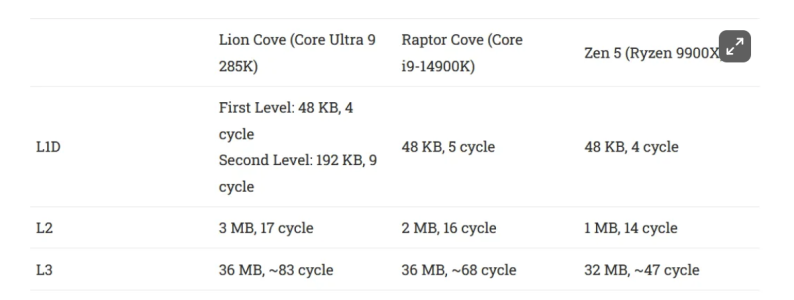

Nice. Looks like my "piece of sh*t" 9900X performs quite well on a technical level vs Intels latest and greatest 3nm "superior tile" technology CPU.
You do know that it is the botched L3 dragging the entire platform down alongside the bad fabric it's not the tile tech or 3nm at fault
