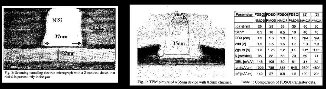

AMD hit the same issues on their 65nm node, which is what caused both the delay and the anemic performance.
AMD shared the same dimensions across 90-nm->65-nm->45-nm.
90nm=40nm Lg // Intel's 90nm was 45-nm/50-nm thus should suffer less quantum tunneling than AMD.*
65nm=40nm Lg (in practice the AMD node for 65nm actually used larger Lgate like 45+ nm)
45nm=40nm Lg
32nm=35nm Lg <-- first real gate shrink. (added high-k which is a known anti-QT tech; same stuff in this is usable w/o significant QT all the way down to 7nm FDSOI(57CPP/40MX))
So, expecting worse quantum tunneling going thru the gate is insane. The actual issue was Xdep; iGISL, iGIDL, iPunch. Which is why everything from 2003-2006 was hyper focused on ETSOI between AMD/IBM till it wasn't. As the larger device shrunk, as the gates stayed the same w/ mobility improvements, they leaked more into the insulator/body not thru the gate-oxide.
*the issue between AMD and Intel's nodes was AMD's PDSOI fixed Xdep for a while. Where Intel suffered most of their working current into leakage of the body.
Terahertz FDSOI vs Traditional PDSOI: "This allows the depleted substrate transistor to have 100 times less leakage than traditional silicon-on-insulator schemes." => Xdep is more significant than quantum tunneling for >20-nm and larger gates. In this case, 7nm FDSOI has larger oxide which allows it to get the same performance/power metrics of N3B. -CEA-Leti CTO.
NostaSeronx
Sep 18, 2011
3,815
1,294
Yes, but that wasn't by choice. Their 65nm node was supposed to have a thinner gate, but that failed, so they bumped it up.
I can't find any PDSOI specific sub-40nm gate length in time for 65nm, but since 2002-2003 there is some for FDSOI.
"This is the first demonstration of a metal gate FDSOI with performance suitable for the 65nm technology node."
The thinner gates were only ever going to come with FDSOI. 25nm and 20nm(late 2003) standard fdsoi were both set for the 45nm node. Only case for smaller than 40nm was with FDSOI, so PDSOI was never going to go below 40nm till 2007~2008 DSL scaling to below 40-nm. Which was set for the 32-nm technology node in its respective paper.
Same applies with Intel's TeraHertz going for 15-nm gate length by 2010. Where the bulk side was 65nm=35nm, 45nm=35nm, 32nm=30nm, 22nm=30/34nm.
More recent stuff allows for gate oxide to get bigger (lowers QT) when Si thickness shrinks below 5-nm. Which is a reversal of "But at advanced nodes, that isn’t possible because gate oxides shrink with the rest of the features." so FinFET/GAA are actually hitting the issue harder than ever.
AMD/GlobalFoundries => UDNA is the FDSOI GPU architecture
The Low-power core that hasn't been seen yet is the FDSOI CPU architecture
Where this is still in play "Products are to be exclusively taped out to and manufactured by FoundryCo." from 7th and amended 7th.
New Geode 52 (officially started 2 years after 50th) = Zen6LP+UDNA, something something ultra-low-power business unit. "server-client-Ultra lower power platforms" 17W/25W for server and 4.5W/6W for client.
12LP+ AI Platform was delayed from 2H2020 to 1Q2025.
12FDX should launch at the same time 1Q2025.
