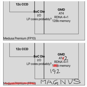

  1. Medusa Halo (AT3)
  2. Medusa Premium (AT4)
  3. Medusa Point 1
  4. Medusa Point 2 "little"
  5. Medusa Point 3 "baby/bumblebee"

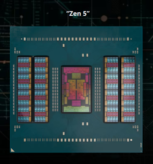

My 9755 has twice the cores as most of my Zen 4 boxes, and while 500w seems like a lot, and the run a little slower than Zen 5, the compute my GHZ is more. 128 cores at 3 ghz vs 64 cores @ 3.5, I will take the 9755 over 9554. (500 vs 400w the 500 is better used for twice the cores)
Point being that more cores in Zen 6 most likely has the same type of winning power/GHZ.
Most certainly! In addition to getting more cores up to higher speeds at the same power, the server socket for DC Zen 6 is getting a hearty power boost as well! On top of that, more memory bandwidth.
I am thinking Zen 6 is going to be a beast in DC!

Medusa premium is unlikely to use 3 chiplets. Medusa halo is unlikely to use 4 chiplets. I think this is just too complicated for the laptop segment.

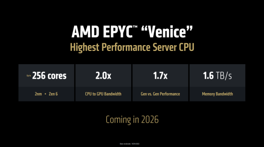

The figure from the slide below is presumably 256 "C" 2nm cores vs 192 "C" 3nm cores. So its at least a baseline to work with. For reference, from Phoronix Geomean testing EPYC gen on gen geomean Linux perf increases are as shown below:
32C 14nm Naples vs 32C 7nm Rome: 39% (34% Blender uplift)
64C 7nm Rome vs 64C 7nm Milan: 15% (3990x vs 5995WX Blender uplift per Techspot is 7%, other sites seem to agree, MT uplift from Rome to Milan was lowest of all gens)
64C 7nm Milan vs 64C 5nm Genoa: 67% ( 46% Blender uplift)
96C 5nm Genoa vs 96C 4nm Turin: ~40% (Blender uplift only 23%, also cant find 64C vs 64C*)
*Found 64C vs 64C 7980X vs 9980X Threadrippers. Blender uplift only 19% per Gamers Nexus
So for the most part, general MT uplift has been much higher for those releases on a full process node advancement. This holds true even for Turin vs Genoa outside of server/enterprise workloads, which seem to be an outlier in that they benefit to a much higher degree from the better Zen 5 arch improvements than "standard" MT workloads such as rendering, compression/decompression, etc. So those workloads aside, Zen 5 vs Zen 4 kind of follows the same pattern as the others-- the largest MT gains come from process node advancements. This means that that Zen 6 will likely carry on that tradition, especially for its 2nm variants.

Hmm...another caveat to consider is that the +70% uplift cited by Lisa and the official slide for Venice is presumably 256"C" 2nm cores vs 192 "C" 3nm cores. This implies that if the 2nm rumors for non "C" core SKUs are true, they will be getting an even larger lithography bump, 4nm to 2nm. If that is true, its quite possible that this +70% figure could be the floor of what is possible.
The MT perf increase from a 16 core 4nm 9950X to a 24 core 2nm flagship could potentially very likely be +85% or more, especially if TDP is raised yet again, say to 200W TDP from 170W. Its very exciting when you consider the possibilities. AMD vs Intel next gen will be fun.
You ain't getting Zen6 with more than 96C on 2nm everything above is 6C
Power will be the limit and on client we have Intel 48C which will be even more Power Constrained than Z6 24C.

?? What are you talking about? We already have 128 P cores on 4nm, why would it drop back down to 96 on 2nm?? In any case, I didnt say anything at all about max number of P cores on 2nm, not sure why you are bringing it up as if I did.
EPYC 9755, 128 Zen 5 cores
