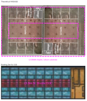

Speaking of cache coherency, reminded me of my musings about it being possible on Zen 5. Since that was a bust, maybe we can dream about Zen 6 or Zen 7?? Just add 4 cores to the CCDs shown below, put the SRAM die under both of them in a "bridge" configuration, and there you'd have it, the baddest x86 gaming CPU known to mankind.
