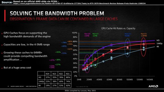

Io Magnesso
Jun 12, 2025
578
165
Why can't it be used for 3D stacked iGPUs? Seems like perfect solution to low mem bandwidth, obviously this needs to be architected into iGPU itself, seems like plenty of time passed since it was first released for CPUs
It's not that V-Cache technology can't be used with Infinity Cache…
It seems that various designs need to be reviewed.
Win2012R2
Dec 5, 2024
1,228
1,273
One would have thought that V-cache would work even better with large GPU because it will be right under it - so latencies can be reduced.
AMD's own RDNA2 info shows that even 128 MB gets 80% hit rates in 1080p, 70% for 1440 and 60% in 4K - so doubling that AND having lower latencies due to placement should make APUs perform real well despite slow RAM.
