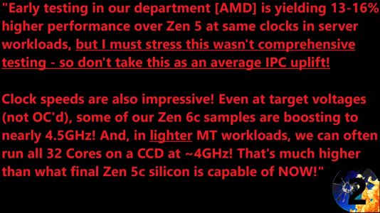

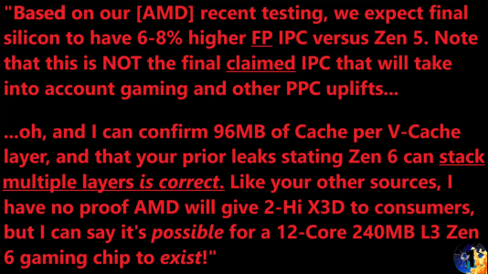

TLDR: a lot of what we heard before about Zen 6 CCD:
- 12 cores
- 46 MB L3 on CCD
- V-Cache die will have 96 MB SRAM
- multiple layers of V-Cache possible, which would mean 240 MB L3 with 2 layers.
- mentions Zen 6 FP IPC uplift 7-9% (ok, but who cares about FP uplift?)
- 32 core Zen 6c cores clocking very well. All core clocks higher than boost clock on Turin) at 4 GHz all core on 32 CCD. (the biggest news in the video)
More than 1/2 of the video is Tom's tariff retardation

BTW, it is possible that very little FP IPC uplift comes from the core itself and most of it comes from better memory bandwidth and latency.
Of course, if it's a single thread, it doesn't really matter...
In the case of multi-threading, when comparing the same core number of Turin EPYC and Ryzen9 9950X due to the bandwidth relationship
There was also a result that EPYC had a much higher score.
- 12 cores
- 46 MB L3 on CCD
The relevant material:
6-8% FP IPC when Z5 already pushed it so far is a good sign for INT IPC, as it has far more low hanging fruit and a good xtor budget to improve it.
2-hi has been possible for some time, but cost benefit is likely too small to justify shipping it, it adds cost, time and lowers final yield which is painful waste.
13-16% server workload PPC could mean all sorts of things, is it per thread, per core or per socket PPC?
That matters a lot eg. 96c Turin socket perf is 40% higher than 96c Genoa but 1T perf is not much more than 20% thanks to higher clocks and 16% IPC.
Could also be Z5c vs Z6c which is a better case for Z6 due to 2x higher L3/core.
I will lean to INT IPC being at least 13% higher though, this is all arguments based on this and the 70% socket perf number AMD gave.
Finally clocks are probably the highest confidence bit of info here, ~4Ghz all core boost with near 4.5Ghz maximum boost for Z6c is huge, which is a leading indicator that clocks will likely make up the majority of the overall performance uplift, 1T and nT.
I think this is quite literally another Zen 4 situation, that got 29% perf/core at the end of the day, this I would lean to 25%.
Add that together and you get ~66% more socket perf Venice-D vs Turin-D, the rest of the gap being interconnect, uncore and memory for a comfortable 70%.
Keep in mind the multi-thread clock boost is partially allowed by the SP7 raising the TDP form 500W to 600W (or more with cTDP?). This doesn't apply to AM5, which has been on the design limit for quite a while.
It really depends on the comparison.
256c Venice Dense is strictly less power per core than 192c Turin Dense even with 20% more power.
You do save a bit of power from the packaging, but the bump to 16ch memory is a negative offset.
And Z5c has a pretty strict upper clock limit no matter how much power you throw at it, the Turin Dense version is the best case of it being N3E and all, but sadly nobody has really benched it properly AFAIK.
Now how this translates with the vanilla cores is really hard to say, it is a bigger node bump in this case, but when you reach 6Ghz it gets really hard to scale further.

Yeah, I didn't really expect anything from FP IPC, just some clock speed increases under load.
But the Zen 6c clocks - HUGE.
Well, we KNOW that Zen 6C is 2nm silicon. We dont know what everything else is using (we just dont). So if non-C comes out using some form of N3, everything fueling the 3x microwave oven clock frequencies hypetrain could be blown to bits. Best to stay grounded at this time. This did appear to have the trappings of a quality leak though.
About floating point uplift, 6-8% is pretty damned good if true. A hypothetical 11900X (I swear I'll puke if they really call it that) boosting to 6.2GHz would score approximately 2640 ST in R23. Thats heroic ST levels folks. If an SKU boosts to 6.5Ghz, its about 2750. Face melting perf. All aboard!!

two things:
1) It's possible that at least a portion of the improvement to FP IPC MAY be related to AMD addressing a latency regression for one or more instructions in FP for Zen5. If they do that much, then the remaining percentage of improvement could just be further tweaks to existing functional units.
2) This will be AMD's first consumer CCD to use nanoflex/finflex. I don't think that people are grasping the importance of that sort of thing when it comes to core clocks. If they can get fine grained enough with it, they can apply different transistor fin arrangements to speed critical sections while keeping the rest of it to more efficient and compact arrangements. Just doing that alone can be worth several hundred Mhz of peak boost clock frequency. I don't think that 6.5Ghz is completely out of the question here. I CERTAINLY don't think that it'll be a sustained clock, even in strictly 1T scenarios unless they are VERY light weight.
