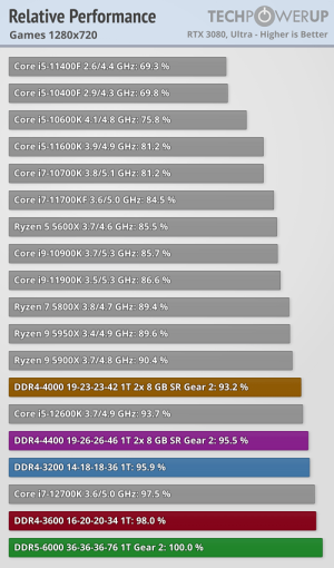

I thought it was universally agreed that gaming was much more sensitive to latency than bandwidth.
Comparing two different memory controllers introduces too many variables into the comparison IMO.

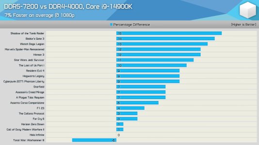

I thought it was universally agreed that gaming was much more sensitive to latency than bandwidth..
Depends on the game engine. Also, Alder/Raptor Lake cores are serious data crunchers and they are starved for bandwidth. You can see it in the video linked in the comments section of the Techspot article.
Only one game engine in their test suite seems to prefer DDR4-4000. Everything else saw an improvement with DDR5-7200.
TPU's testing is older so we could say that DDR4-3600 is roughly equal to DDR5-6000.
The individual game results show how different each game engine is in its memory access patterns so there's no real clear winner but I bet DDR5-7200 would've come out as superior in most of these games.

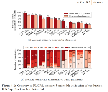

1. Life Science and Biological Simulations such as NEMO (Ocean Modeling), CFD, Machine Learning, Graph Analytics, Video and Image transcoding and processing, In memory databases like SAP HANA, Data Analytics like Apache Spark, the list Stefan also provided.
Do you have any benchmarks showing how much impact the memory bandwidth has for such use cases?
