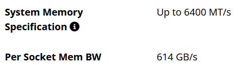

MRDIMM 12800 with 16 channels doesn't get you 1.7Tb/sec (my math could be wrong here). You are right though. DDR8000 doesn't make that number either.
Even MRDIMM 8800 gets you 2.25Tbyte/sec of bandwidth so that doesn't seem right either.
Does anyone have some math that makes sense for 1.7Tb/sec?

You sure you have the same calculator as the rest of the world?
8GB/s per 1GT/s
x
12.8GT/s
x
16 channels
= 1638.4GB/s
Possibly not!
If it's 8bytes per transfer I see your math. Thanks.
So Venice D gets 6.4 GB/sec/core.
Does this come at a latency penalty over DDR8000?
