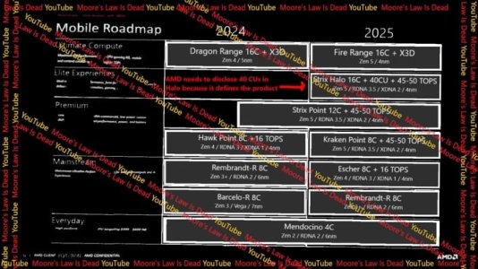

Imagine Strix Point successor with LPDDR6.
136 GB/s -> 228 GB/s memory bandwidth (+67% uplift)
+ SLC cache...
We could be looking at double the iGPU performance..

I look forward to the day MLID will leak the 2026/2027 version of this slide:
Zen6 APUs
