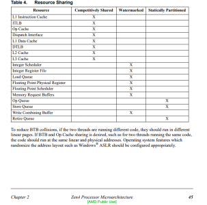

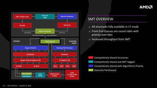

Thats definitely not true for SMT on Zen - resources can be dynamically partitioned between the two threads.
Internal structures are splitted by threads needs but threads are equal - there's no way to differentiate executed threads speed.
naukkis
Jun 5, 2002
1,030
854
No need to speculate, the SOG says they are shared dynamically. Only 3 resources are statically partitioned rest are not.
Dynamically shared doesn't mean that theads are not symmetrical. Both threads have equal rights to all cpu structures and caches and those are given to whatever thread needs it. By sharing them dynamically cpu best uses it's resources. Both running threads still has equal right to resources - and if running exactly same code all should be shared even.
