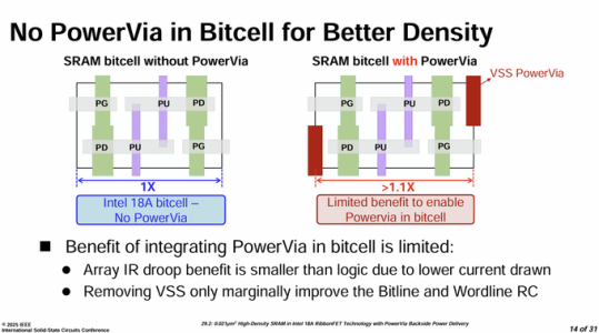

L3 cache scaling slowed drastically from N5 to N3. The most notable density increase came from a cell rearrangement. BSPD will allow another density increase, but that's not until A16.
