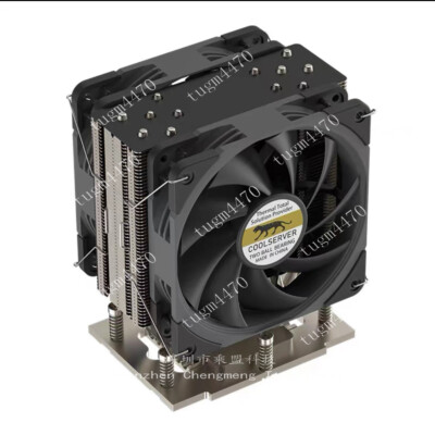

Thanks. This one:
Is 6 pipes and all the ones I have are 5 pipes and do fine on my 9554's, so since the Turin runs cooler, I am sure that will do fine. If I can ever fine memory that is recognized and it can start loading an OS
