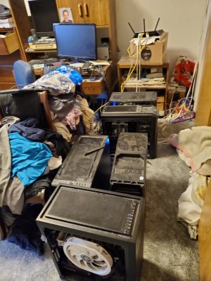

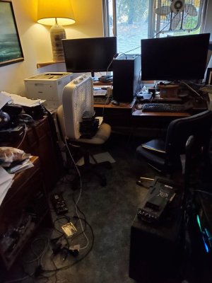

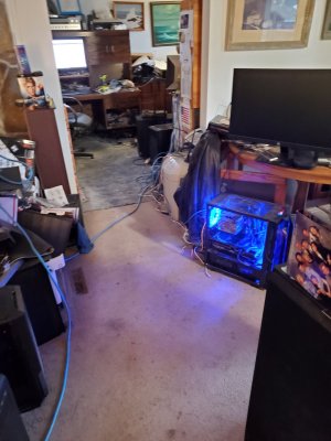

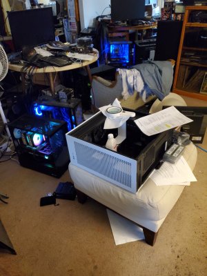

And where do you suggest a flat open space to put this ? and where to get the power from ? They are all over the house to spread out the power to different outlets.

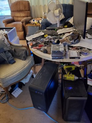

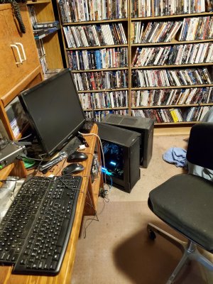

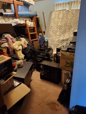

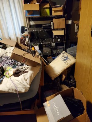

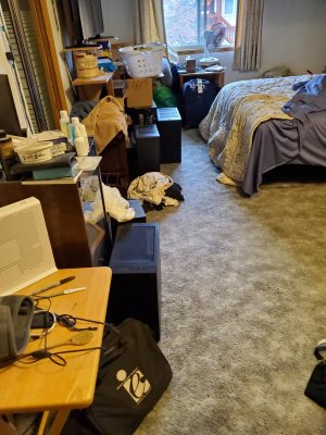

whelf space ? one room filled to the ceiling with stuff, the other 4000 dvd's living room has a piano on one wall and the other behind the dining room table. Kitchen with the usual cabinets. my room above the bed or TV or a few pictures. NO ROOM.

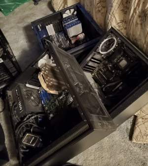

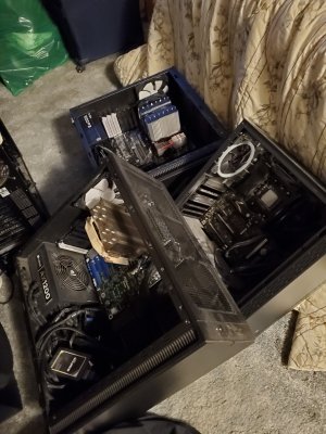

They usually are I was working on them for prep, 2 of these I am giving away to chur/family. If you look they are stacked even 3 high in the room with all the beds. Thats where the non-active boxes are that are actually 1/2 cases and half boxes. Like a 1700x from 2017, a 1950x, etc...

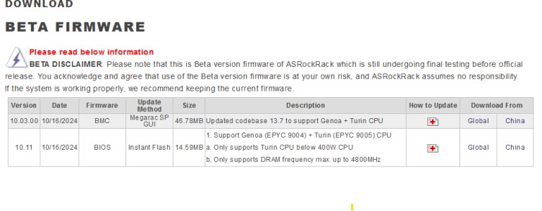

Why could I not find that ?? Maybe I will try it. I can always use another Turin when the other is available.
I can't click on anything above and I can't find it online. If you can link that page it would be great !
Edit: duh... There is a link for "beta zone", thats it
