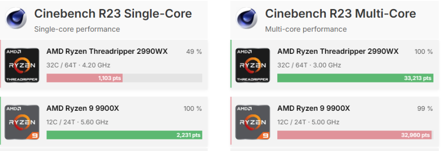

Not sure if I realized before and forgot and realized again, or if I mentioned it before, but the 9900X is roughly equal to the 2990WX in nT, and double in 1T. Pretty spiffy.

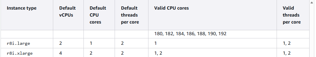

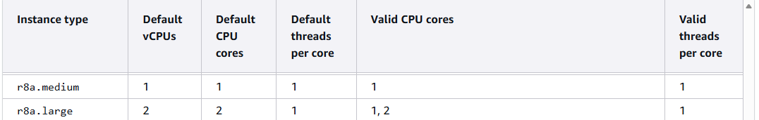

Author of the blog misreports instance cost (if he is really running r8a.large & r8i.large) - intel instance is actually cheaper (same as for general purpose / or memory optimized instances fro both Sapphire & Granite Rapids vs. Zen4 & Zen5). It can easily happen because cost in instance type selection when creating new instance is randomly ordered for different OS ("vanilla" linux is cheapes, SuSe, RedHat, Ubuntu or Windows have higher prices - btw. its absurd UI fail)
The twist is, that while Genoa & Turin instances run with SMT being off (1 vCPU = 1 CPU core), Intel's instances are ran with SMT on - that is why they do not offer "medium" instance (1 vCPU) in intel's case but offer it for Zen4 & Zen8 instances. (1vCPu = 1Core is true for general purpose, compute or memory optimized - m/c/r 7&8 Zen4 and Zen5, it wasn't like that before - for Zen3- e.g. m6a)
Not that it changes the result, but the perception & interpretation correction is needed in my opinion. This is also the problem of comparing Azure vs AWS now, because Azure is running AMD Genoa & Turin instances with SMT on (2 vCPUs = 1c/2t).
see: https://docs.aws.amazon.com/AWSEC2/...stances-values.html#cpu-options-mem-optimized

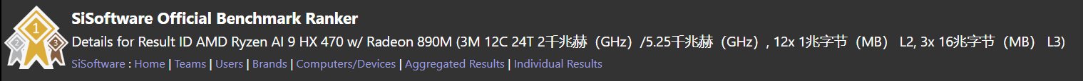

Gorgon Point gets L3 change? 3x 16MB?? This would be an upgrade from Strix Point if true, or is this just a misread by the software?? Almost certain this has to be an error in the software reporting as that could be a doubling of L3 vs Strix Point, huge change in silicon.
CouncilorIrissa
Jul 28, 2023
788
2,855
100% software reading issue. Very common occasion for multi-cluster CPUs.
HX370 also has 3x 16MB according to SiS.
