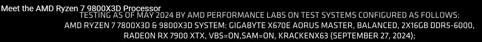

No they tested 7800x3d vs 9800x3d with, a 7900xtx and 9800x3d vs 285k with 4090 :)
