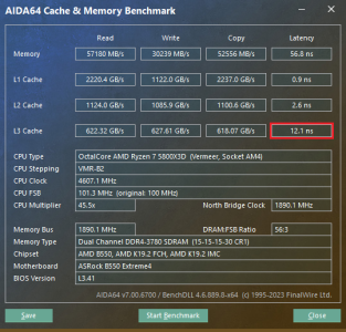

13.84ns? ))
Is this the same well-known bonus for using Windows OS Beta-testers Edition (sometimes referred to as Windows 11) ?
The absolute latency difference (in ns) will be down to clockspeed difference as you correctly identified.
Besides purely architectural aspects, 5800X3D L3 latency decrease with higher clock (not sure about Zen4 X3D though) is limited by a fixed L3 EDC limit (unlike the regular Zen3 where it increases linearly with the VddCpu EDC limit)

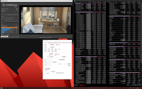

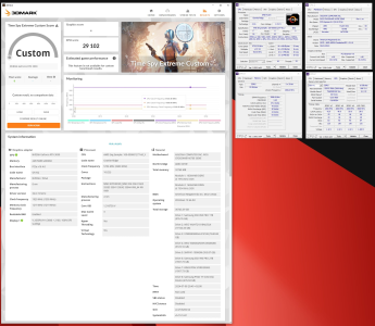

Det0x
Sep 11, 2014
1,490
5,117
Aha!! How can you possibly you know this? :wink:
How can i share all these screenshots on release day of Zen5 ? 🙃
And be sure i have played enough with the 7800X3D and 7950X3D v-cache models to know my way around their V/F curve and how they compared to regular Zen4 chips
You talked about 5.5ghz earlier.. I have actually done 5.8ghz on a 7800x3d already
Z4X3D is vcore and temp limited (if you dont know secret tricks to work-around)
Vcore limit is kinda der8auer fault as AMD realised they didnt want scrubs killing their cpus
But even if there were no vcore limit, the Zen4 core are reaching lower clockspeeds compared to the Zen5 core, at the same set voltage (power usage is higher on Z5 tho)
This is highly binned 7950X @ 1200mv set static = 5350/5400 max allcore clocks
This is a highly binned 9950X @ same 1200mv set static = 5500/5500 max allcore clocks
And i have said too much about the other limit already....
Josh128
Banned
Oct 14, 2022
1,542
2,295
And be sure i have played enough with the 7800X3D and 7950X3D v-cache models to know their V/F curve compared to regular chips
Perhaps I should be more frank - if you have it in hand, throw us some more bones my dude! :p
When might we expect to be hearing some more info? Oct 10 possibly?
Det0x
Sep 11, 2014
1,490
5,117
Are both your ccx's equally good? 😯 And do you by chance know what clocks you can roughly expect from an average retail 9950x? (@1200mv)
Thats why i get my #6th retail 9950X sample tomorrow, trying to find silicon that can match my ES sample.
Need a good retail sample so futuremark can stop hiding my results because ES --> "Processor is not recognized"

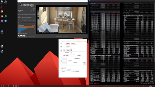

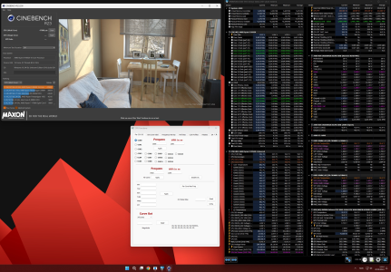

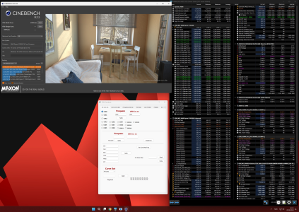

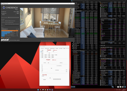

I haven't updated "chart" with my soon be #6th yet, but this is my 3 first retail samples

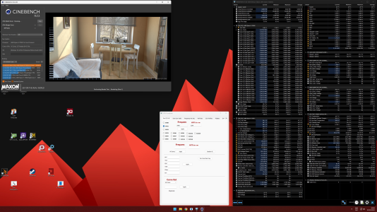

  • The goal was to complete 3x MT runs in a row in Cinebench R23
  • Static cpu voltage was set at 1.200 vcore --> around 1.156 vcore get while running (since set in windows only hwinfo motherboard vcore is correct reading)
  • Static clockspeeds was upped on each individual CCDs in 25mhz intervals before it could not pass 3x runs back to back
  • I tried to keep the watercooled same loop GPU idle temp as close to 20 degrees as possible for all runs (most reliable for me)
  • Non of the runs were done at stock 5600MT/s speeds, but not maxed out either --> was just what i was running at the time of testing
  • Nevermind the R23 MT score themself as i had lots of stuff running, lowering the scores. Point of interest was clockspeeds
  • HWinfo got reset before each run, all runs seems to be about +- ~260w powerusage while running Cinebench R23 MT
  • Stupid windows11 printscreen would only take screenshot the same millisecond the benchmark ended on all but the ES, but values in hwinfo hadn't had time to update.
Retail #1 9950X sample
Max stable FCLK = 2167mhz
Max static R23 ST clockspeed @ set 1.4core = 5825mhz
Max completed MT clockspeeds = 5500mhz CCD0 / 5450mhz CCD1
Retail #2 9950X sample
Max stable FCLK = 2200mhz
Max static R23 ST clockspeed @ set 1.4core = 5850mhz
Max completed MT clockspeeds = 5550mhz CCD0 / 5425mhz CCD1
Retail #3 9950X sample
Max completed MT clockspeeds = 5500mhz CCD0 / 5425mhz CCD1
ES 9950X delidded sample
Max static R23 ST clockspeed @ set 1.4core = 5900mhz
Max completed MT clockspeeds = 5500mhz CCD0 / 5500mhz CCD1
Jimster480
Aug 30, 2024
