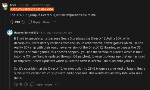

Someone already ran the benchmarks with X3d chip on AMD subreddit. 12% more scores on Geekbench!
Looking only at GB6 the before results are extremely low and suspect.
Even the after results are lower than a stock 7800X3D in an old build of Windows 11.
The poster says they had a bunch of background programs open which makes it almost useless results - who knows if the programs were doing much more background work in run A vs run B.
