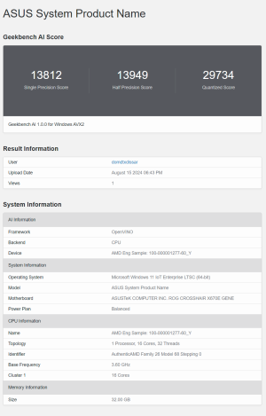

Det0x
Sep 11, 2014
1,490
5,117
New Apple AI benchmark released
No idea if this is a good or bad score for Zen5 16core
Cant find a single 13900k / 14900k result, crashing all these systems ? 🤣

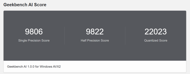

12,501
Judging by the name, it seems like there is no AVX-512 support which is a shame. I don't know what this bench is doing, but there are multiple AVX-512 instructions specifically for speeding up AI tasks.
28,174
19,218
Didn't see the comparison between 9950X and 7950X? That uplift isn't from a generational IPC bump.
AVX-512 is very much being used.
Reactions: Tlh97 and Josh128

Hitman928
Apr 15, 2012
6,755
12,501
