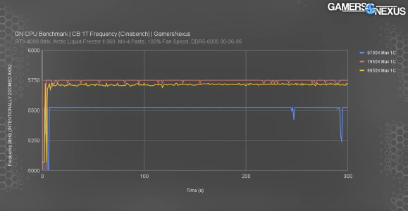

Zen 5 holds its 1T boost just fine? The axis marking suck, but it is holding just a hair over 5.7 GHz the whole run.
9950X clearly doesnt hold as well as 7950X in this example, plus its about 50MHz lower. 9700X looks fine, but is this R23 or R24? 24 seems to require less power per/Mhz than 23. If it is 23, then AMD just flat out lied about Zen 5s +17% IPC gain in R23. 7700X scores ~2000 ST @ basically the same 5.5GHz boost clock (even though its rated for 5.4GHz). This should put the 9700X at a cool 2340 pts. I have yet to see a >2300 R23 score for any 9700X @ stock, but I may have missed it. 9950X should be touching 2400 but also comes nowhere close to that.
You said that Zen 5 can’t hold its boost, this clearly shows it can. Anything above 5.7 GHz is above stated boost and will depend on the specific sample being tested, just like with Zen 4.
No I did not. I said it can barely hold its 1T boost. I said this, because Zen 5 5.5GHz = Zen 4 5.4GHz, and Zen 5 5.7GHz is 30-50 MHz less than Zen 4 5.7GHz and more erratic (per GN and Chips N Cheese). Also, despite having a more power efficient variant of process node, Zen 5s 9950X top 1T boost pulls about 5 to 10W more power than 7950X top 1T boost per Toms Hardware. The point is, it appears it takes more power to get Zen 5 to match Zen 4 clocks, whether 1T or nT, so theres no logical reason to expect miracles in clock speed from Zen 5 X3D.
I guessing I interpreted barely able to as struggles to. So what does barely hold its boost clock mean? How is that different from clearly staying at or above its boost clock?
There are Zen 4 samples that can’t reach above the stated boost clock, so comparing single samples or a small number of samples is meaningless.
