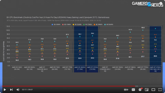

From GN: FinalFantasy 14 Benchmark, power draw, 7600X vs 9600x. The spikes in the graph are main loading points for the benchmark. So from this data, the 9600X is pulling more power running the benchmark except at loading times.
Screenshot 2024-08-13 at 17-37-39 AMD's Zen 5 Challenges Efficiency & Power Deep-Dive Voltage ...png
Edit to add Power cost per year chart:
Screenshot 2024-08-13 at 18-09-27 AMD's Zen 5 Challenges Efficiency & Power Deep-Dive Voltage ...png
