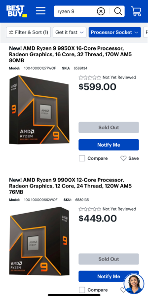

279 and 359 don't make much sense to me to fit in with 449 and 599 pricing- it's $7-9 more per core than the dual CCD skus. I would have expected something more like 249/329/449/599

Pricing is meh, especially for 1 CCD SKUs. $329 for 9700X would have been irresistable. As is stands, I'll probably wait a bit.
