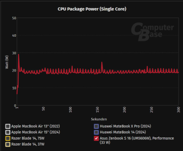

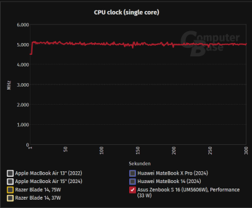

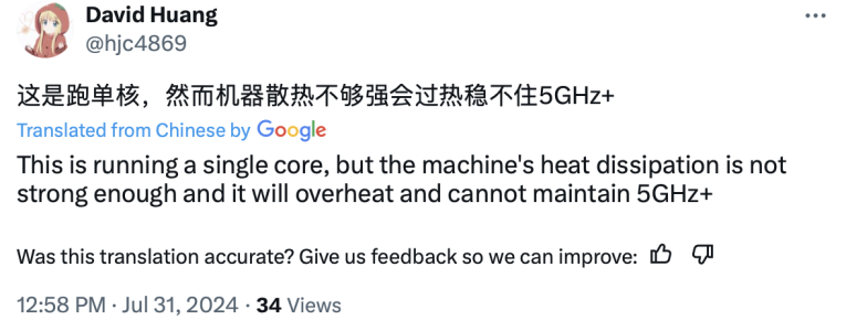

It seems David has issues getting STX to boost to 5.1
thats on linux too. So Geekbench was reporting the right clocks then. So its okay for AMD/Asus to advertise fake boost clocks and all Strix machines have fans but when Apple doesn't maintain ST clocks on a fanless machine its a scam...
No wonder AMD didn't increase boost clocks this gen. They couldn't!

thats on linux too. So Geekbench was reporting the right clocks then. So its okay for AMD to advertise fake boost clocks and all Strix machines have fans but when Apple doesn't reach maintain ST clocks on a fanless machine its a scam...
Let's see if other thin&light devices behave the same way.
Thicker devices seem to handle the boost clock fine.
Looking into it yes it seems the smaller Asus laptops cannot reach the 5.1GHz. The 16" Zenbook seems fine tho.
EDIT: To add some more notes it seems the 5.1GHz boost clock consumes up to ~29 watts. I think that is too much for the smaller Asus laptops to handle for longer periods.
