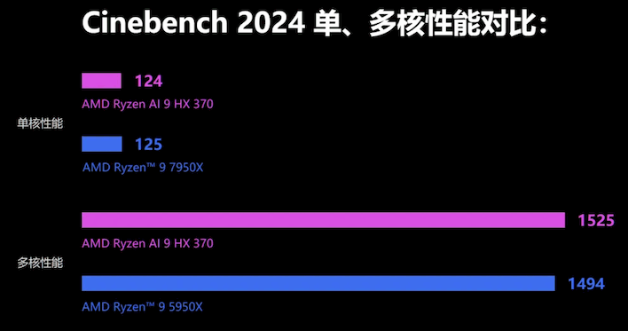

Shouldn’t that affect the fp score as well? Seems particular to just int.
~5, percent?
I'm making some assumptions that may turn out to be wrong, but if they are correct assumptions, then that would just mean that FP increase is higher than Anandtech shows.

There's a problem with that Math and that Problem is ZEN5c. Clocks of 8 of the 12 Cores are Limited to 3.7GHz. Computerbase got an avg core clock of 3.43GHz at 33W. So starting at 40W, there's only 4 of 12 Cores that can scale further. So basically at that point every scaling is gone. Even if those 4 Cores got to 5.0 GHz that's only a 11-12% uplift over 40W. No matter how much power you throw in there. 1400 isn't possible.
GPD displayed a run that scored 1525, so that s outright possible, beside the 8500G APU wich is 2 + 4, so half the 370, can go above 45W according to Phoronix review.

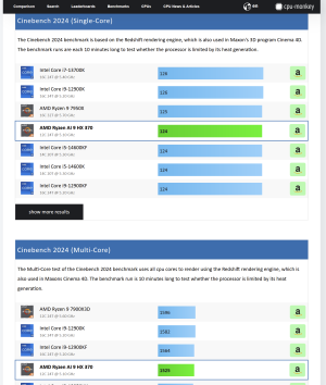

I have doubts for actually ran this themselves they just copied those numbers from cpu-monkey who just applied amd 17% ipc uplift to zen 4 numbers
Good catch, those are just CPU Monkey numbers which are known to be made up, specifically for pre-release hardware. We have actual tests now that show that 1525 is not happening. Even 1400 is out of reach.
That s the other way around, CPU Monkey collect numbers here and there that they use for their database, not the first time they did so, they often use numbers that are allegedly leaked even before there s proved tests.
And in case you dont know GPD manufacture devices using AMD APUs,
why would they need to rely on obscure sites since they have ESs long before the consumers have access to actual products..?.
Guys you may have it backwards--I believe CPU Monkey used that leak and added to its site, not 100% but they did the same thing after a few other leaks.
I am inclined to agree this is probably what happened. CPU Monkey will aggregate results they find anywhere and everywhere - It seems much less likely an actual OEM system manufacturer would just peel numbers off CPU monkey.
That's Marketing Material. With the 3rd Party reviews from today, 1500 should be impossible. We will see. But 1500 would be literally around 5.0GHz on all 12 Cores, which isn't possible. And I don't say the CPU can't go above 40W, I said scaling will be dead above that value, because only 4 of 12 cores can increase their clock. So for every % perfomance, the Cores need to increase the clock by 3 times as much as before.

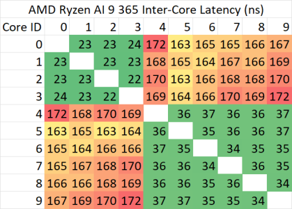

Nearly 2 GHz fMax difference between Zen5 and Zen5c cores.
Core-to-core latency within the 4 core Zen5 CCX worse than that of the 8 core CCX in Phoenix and Rembrandt.
Meteor Lake latency all the way to the LP-E cores is better than this.
IIRC AMD said that they extended the frequency range of the C cores, indeed they are only 25% smaller than the regular cores where Zen 4C was 35% smaller than its counterpart.
