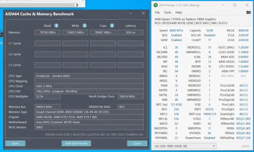

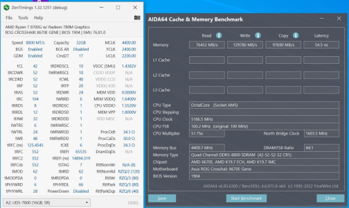

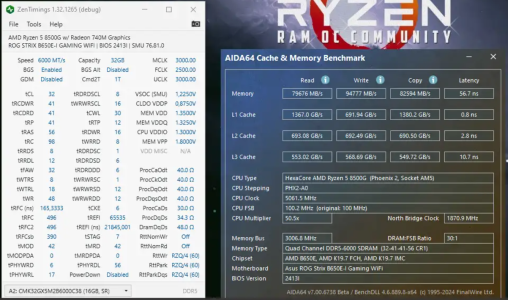

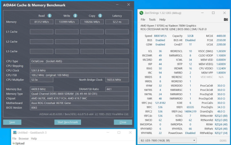

~70 GB/s read is the hardlimit @ 2200mhz FCLK for a single set of GMI links (single CCD), even at 8800MT/s memory speed)
~76.5k GB/s read is the hardlimit @ 2400mhz FCLK
And ~81 GB/s read is the hardlimit @ 2550mhz FCLK
You only need ~6000MT/s memory speed to fully saturate 2500mhz FCLK read limit (screenshot below is not mine)
Like i wrote on previous page, Zen4 and now Zen5 is pretty much all read bandwidth limited by FCLK, while write is not.
You gain like + ~50% read bandwidth compared to single CCD when running a dual CCD CPU.
So theoretical, if the italian guy were really running 2400mhz FCLK on the 9900X, he would have around ~115GB/s read numbers in Aida
