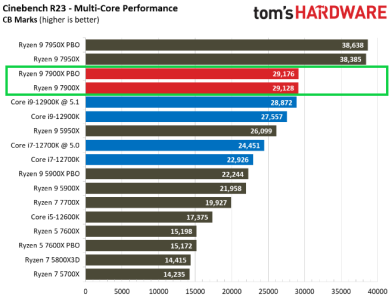

Great, and you point is (other than showing that Tom is using a bad cooler)?
Article says that 7900X (with PBO enabled, which in case of not enough cooling does not improve vs stock) at 170W TDP is worse than a 9900X stock, and said 9900Xstock with PBO (which with all probability is still lower than 170W) s even higher.
This tells two things: Zen 5 runs cooler than Zen4, and the +14% is achieved at a lower power consumption, with some more power (likely less than standard TDP of 7900X) the difference increases.
Those charts mean nothing, what matter is the actual power, in Cinebench R23 the 7900X is at 175-180W.
This chart was intended to illustrate the fact that the 7900X gains very little from enabling PBO in CB-type workloads, so the 14% MT uplift assumption still stands.

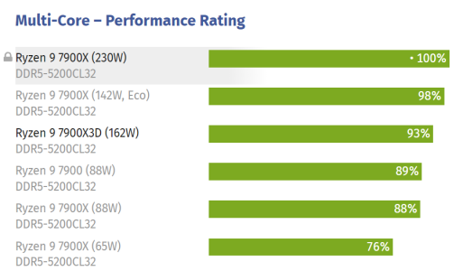

Your link has only one 7900X result in the test
It's an interactive diagram. There are more entries to be seen when clicking the "+ 183 entries" at the top right. Using the Developer Tools, you can even reduce the diagram to just the 7900* entries:
The wattages are PPT values. Overall, in multi-core-tests, the 7900X loses 12% performance when lowering the limit from 230 to 88 watts. When clicking "Edit", the individual benchmarks can be turned on and off, showing that the biggest performance loss of -15% happens with Cinebench R20 and R23.
You can also see that a limit of 142W costs almost no performance. This makes it clear that they could have released the 7900X as a 120W TDP model with basically no difference in performance. AMD adjusting the TDP of the 9900X down to 120W is just acknowledging that.
