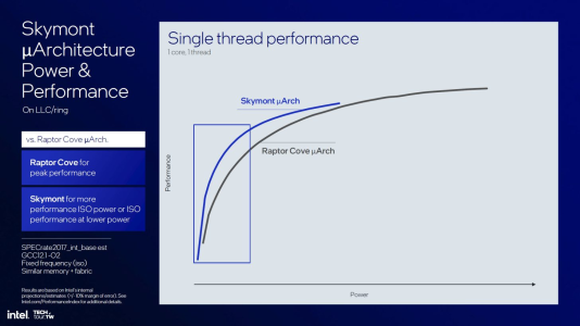

Unless Intel has decided to completely mislead, The "E" cores are about as fast as Zen 4 +-10%.
I think X3D chips will be the champs of gaming. I don't see Intel overcoming that. I think Intel will probably win this gen overall (minus gaming) unless AMD does something uncharacteristic with X3D, which is a very real possibility. :)
If intel is right, the E Cores are faster than Zen 5 at the same power envelope (20% faster than Raptor Cove at low power). Discounting AVX512 workloads of course.
Edit: in lunar lake will be a bit weaker due to no l3, so maybe faster than zen5c and close to zen5.
We seem to be throwing IPC and performance around synonymously which is causing confusion. If Intel slides turn out to be correct, then Skymont should be more or less on par with Zen4 IPC-wise (which is still fairly astounding and a great accomplishment by Intel). However, there is still a sizeable gap in clock speed with Zen4 DT and Skymont so I wouldn't expect the performance to be close.

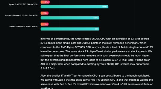

That was the reply to the clock speed. 9600x production CPU has higher boost clock speed than 5.1 GHz.
And yet, videocardz says that this result is from stock 9600X. Something doesn't add up in their leaks.

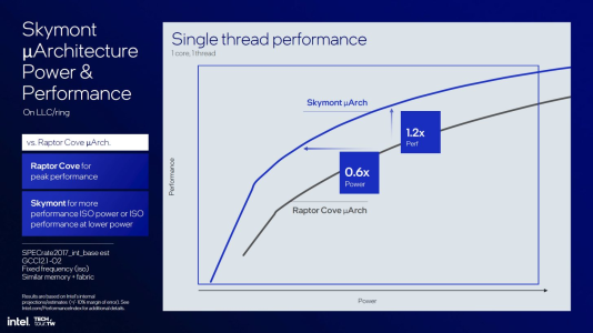

Skymont/Raptor Cove IPC is Zen-4 like. But Skymont is 20%-80% faster than Lion Cove in its power range, which means it is very likely faster than Zen 5 in that power range, unless Zen 5 is vastly more efficient in that regime, which may be, but I don’t see evidence of that.
In this case WCCFTECH have better reporting than videocardz
775,9 points / 5050mhz * 5700mhz = 875 points
Earlier result from the same ES was ran at 5050mhz, not stock 9600X 5300mhz clockspeeds like videocardz claims
(this was even shown in the video posted like 5-10 pages back)

20-80% over lion cove has nothing to do with die shrink
dawg they compare against RPC. please.
Since it is +/- 10%, it could be Zen 3 to Zen4c territory, with 1 or 2 node advantage, 1-3 year behind Zen 3 / Zen 4c
Intel numbers are usually accurate enough, that footnote is just-in-case stuff.

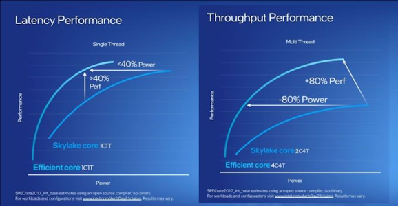

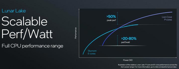

Ah, they compared to both. I’m talking about the lion cove comparison:
You said you have Zen 5 power scaling performance data, so I don’t know if 20-80% isn’t enough to keep up, but I think it may be close. I doubt Zen 5 is more than 20-80% efficient than lion cove.
That's not remotely iso comparison since LNC requires lighting the ring on fire.
LP crestmonts also have way lower power floor than RWC.
RPC comparison is very much iso fabric aka Atoms hang off the ring.
Jun 4, 2024
You can always compare PHX2 versus RPL-U 282; not that hard.
Yeah I just did. Best comparison I’ve found so far is AMD’s claim of something like 80% better PPW compared to 155h (vs 8840u), though that surely includes some less than favorable circumstances. Stacking another 20% on that… that does seem hard to beat. We’ll see.
adroc_thurston
Jul 2, 2023
8,616
11,332
Can you read?
I've said RPL-U and PHX2.
That's the most apples to apples stuff out there, 2+8 versus 2+4, both backed by an on-ring LLC and both do it well at 15W.
I'd say, not much )
Ryzen 5 9600X (5.7 GHz OC ES)
Ryzen 5 9600X (5.05 GHz Stock ES)
And indeed, without fit/cca/whatever throttling Zen shows perfect linear scaling in CPU-z both ST and multi.
