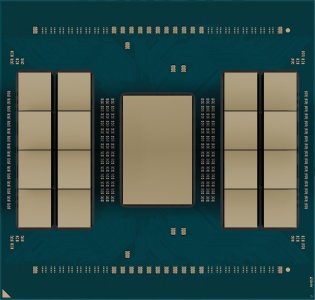

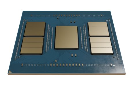

I was assuming that it is still 2 CCX per die like it is in zen4c. Do you have something indicating that they changed that?
There still is merely the old rumor of a 16 core complex, no public info from AMD.
I also haven't really seen any indicating that it actually has more than 12 infinity fabric links on the IO die.
AMD subsequently gave minor clarifications to the press. Renderings from AMD:
Turin classic, up to 128 coresTurin dense, up to 192 cores
(source)
