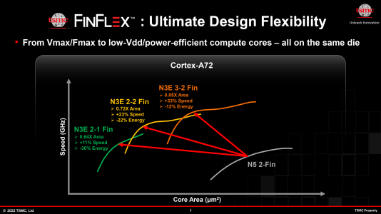

I think the point is not only allowing denser configurations, but IIRC these core are also optimized for a different frequency range (lower power than the regular Zen5 cores at low clocks) so they allow to save power in the configurations/situations when clock is not so high (idle, low load, high core count servers)
That is the covered by the physical implementation, like mentioned. Device characteristics influence leakage, frequency, area, efficiency, operating voltage, drive currents etc.
N3E would offer much more differentiation with 2x1 fins vs 2x2 fins, but having a totally different RTL for c cores is what I am suggesting they should go for in addition to physical implementation.
Imagine the space savings a N3E Finflex 2x1 fin Zen5c core without the 512 data paths vs vanilla Zen5.
RTL?
Imagine the space savings a N3E Finflex 2x1 fin Zen5c core without the 512 data paths .
I wonder what the clock speed loss is, when going from 2-2 fin -> 2-1 fin.
Possibly that was a plan but TSMC's delays on N3 process pushed AMD to do otherwise in the mobile/desktop area. Same capability core, moreover, should simplify scheduling.

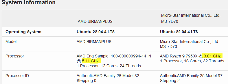

You wouldn't get rumours of +40% then it's 16% BUT the power draw fell by a lot.
It's actually interesting that the 1T IPC numbers in one AMD barchart are lower than the nT performance uplift in the comparison with 14900k(s?), seems like either the frequency does not tank that much on Zen5 with multithreaded load as compared to Zen4 (5.1-5.2ghz on my 7950x3d with light sse loads, less than 5 Ghz in heavy AVX2 load), or maybe it's just "Intel (tm) (C) default profile" that tanks Raptor Lake MT results :neutral:

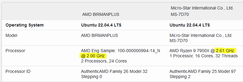

Please share the links. Please *puppy face*
1224@2.3G = ~3.0K@5.7G
1024@2.0G = ~2.9K@5.7G
I added my reference 7950X at 2.0G and at 2.3G
One of these scores have nerfed AES XTS
And GB5 scales linearly with frequency.
