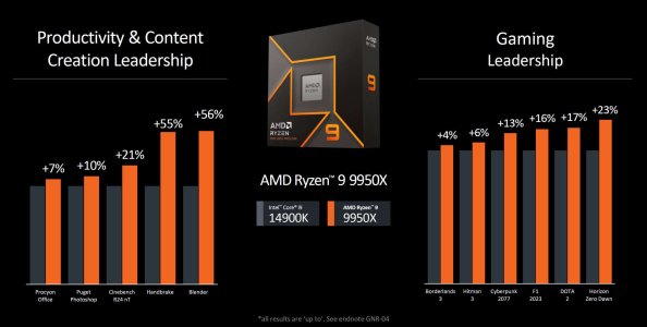

Hm, so it's 26% faster. Nothing too special. We know about 16% average ipc, so this is just a bench in the upper region. Why is everyone acting as if it was super high?!
Yea, ‘Nothing too special’. Even the 2x% gaming number already on slides, people still decide not to believe. Dunno why we are riding on a DownplayTrain consciously since HypeTrain crashed.
It's even comparing to 14900k and no one care about.

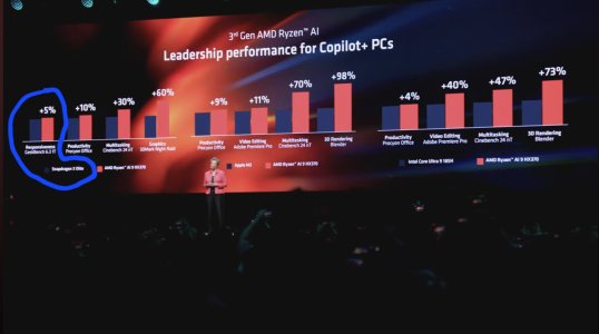

There is this:
You would think there is, but if you check the end notes for that slide... they say it's GB multi-core score. You can find the mobile slides here: https://www.anandtech.com/Gallery/Album/9476#25 (also be aware this slideshow contains the desktop endnotes as well, even though the desktop slides are in another article)
Are decreases or very slight increases in IPC likely for significant tests?
Their IPC figure is given for a mix of ST and MT workloads. According to their end note they were comparing at fixed clocks, but the SKUs chosen make no sense (9950X vs. 7700X) The problem with the benchmark mix is one cannot isolate MT or ST increase, it's a weird mix between the two.

12,500
In the past, they have compared 16 core SKUs to 8 core SKUs at iso clocks but disabled one of the CCDs on the 16 core SKUs to match core count as well. I’m guessing the same thing happened here, they just forgot to mention one CCD was disabled.
This makes the most sense, the alternative being 9950X vs 7950X. There are more typos/small mistakes in the slides though, making the keynote materials seem rushed.
