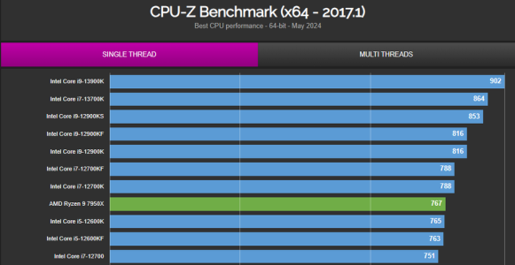

Zen 5 CPU-Z single core benchmark is supposedly 910. Will share source soon.
EDIT: Sorry,, I put the twitter link below, had to get to a desktop. I wanted to link the original baidu post, but have had issues.
That is for the engineering sample of Zen 5. For reference I get around 740-750 on my stock 7950X, so about 21% higher. Not bad.
Oh and if this was already posted, apologies. Sometimes this thread moves quite quickly and it can be hard to keep up.
For comparison , Zen 4 achieved 1% vs Zen 3 and Zen 3 got 12% over Zen 2 ( IPC) in CPUz 1T.
Zen 5 getting ~20% in this archaic benchmark bodes well for the average IPC uplift number. Zen 4 was cited to be between 11 and 13% IPC uplift (average) while Zen 3 average was ~19%.
CPU-Z isn’t the best benchmark to begin with, but for what it’s worth…

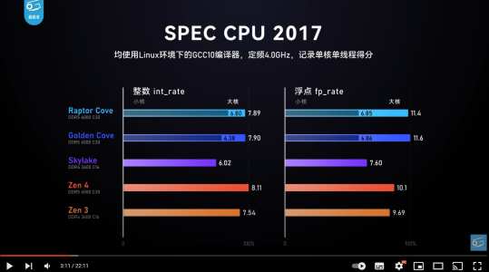

There s no FP bench where RPL has better IPC than Zen 4 excepted in the ICC compiled Cinebench, so why did CPU Z IPC increase only by 1% in Zen 4 when all other FP benches were at least at 10% ?
Beside Zen 4 had even better IPC improvement in INT code than in FP, so this has nothing to do with either FP or INT.
This has likely do with some instructions not being used on AMD, same as Povray
that gimp AMD by 16-18% since it use AVX2 only with Intel CPUs.

There s Povray that is included in Spec_FP, and as said it doesnt use AVX2
for AMD, so much for the clowning, i guess that you didnt even notice that this
bench was in SPEC.
FTR Zen 4 perform 16-18% better in Povray once AVX 2 is enabled for this CPU.
Ah yes, that one subtest explains the 15% difference found by geekerwan lol.
