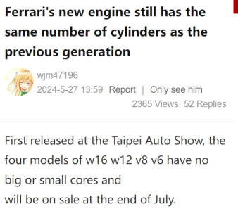

Guess i will be getting a new ferrari w16 engine in a few weeks then since i'm bored with my 8500G, 8700G, 7800X3D, 7950X and 7950X3D :sweatsmile:
Videocardz made a post about it also

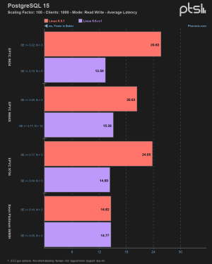

And a ton of things can also be surprising once certain ucode optimisations come through:
V$ used to be the best in class with latency among EPYCs, became the worst.
Bergamo was 2nd, stayed 2nd, while Genoa went from worst to best.
Just from upgrading Loonix 6.5 to 6.6rc1.
V$ is not as all-around good as one might think. It also forces the power/temperatures down a bit because it's fragile heatwise.
It's amazing for gaming, less so for most other stuff.
